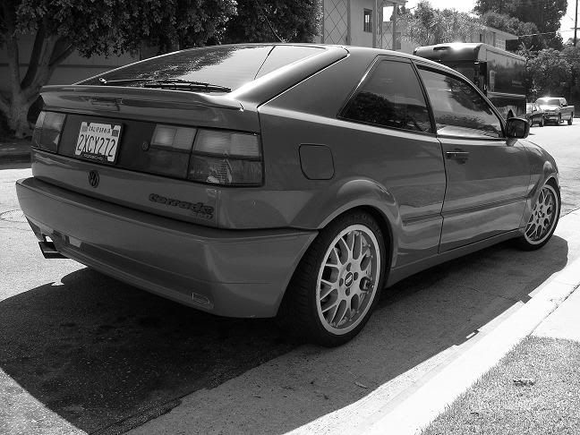

Yes, it's a locking c-clip, should be able to get something from Home Depot or Lowes. Nice pic of your car.
