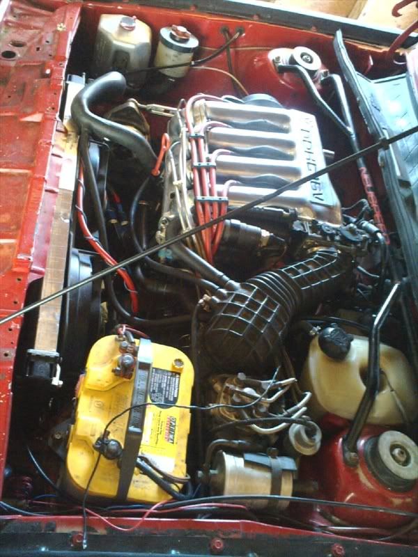

I just 'finished' my scirocco build finally!! Actually, I just got to turn the key and start the new built engine for the first time yesterday. But, I seem to be having running issues that really don't make any sense to me, and I am far to frustrated to keep dealing with it on my own. Are there any scirocco guys that know their **** near by?!? I have tons of stock parts and what not I could trade for your time
