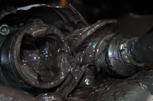

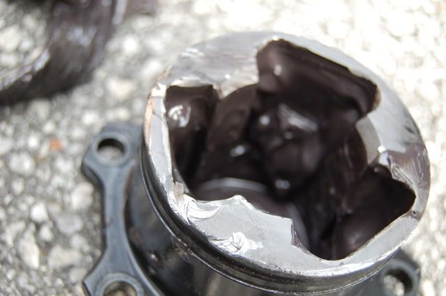

Long story short. I punched the gas and BOOM! and then silence...the car rolled to a stop and wouldn't budge. A cop saw me and pushed the car two blocks to a side street. I went and bought a new axle and installed it on the side road in 20 min. started driving it home and couldn't go over 5mph. Wheel bearing was f-ed too! Bought a new bearing today installed everything and she is still F-ED up!!
^^You can see where the caliper carrier was touching the rotor in this pic...rotor has deep grooves in it now

I don't know...the thing that gets me is its only the pass. side. I've only replaced the driver's side once and that was only because I was replacing the pass. side and figured why not.
I think something inside the transmission is jacked on that side. I'm just scared to take it somewhere, I don't want to hear bad news...I'd have to flat bed it to a shop as well something else I don't want to do
I have NEVER seen anyone go through CVs like you, and you're not running crazy power, cause you're not even chipped!!!!
And, no offense meant at all, but you aren't that low! It doesn't even look like your CV or body have any marks from rubbing one another.

Called the dealer today. The flange that connects to the inner cv joint has a shaft on it, this shaft could be bent which would explain why I'm leaking tranny fluid from that area.
Flange = $306
Seal for the flange = $53
The guy also told me there are 5 different axles listed for the pass. side of an automatic FWD A4. He said the problem with Napa and Advance is that they have a "universal" type axle and don't take into consideration the length of the shaft that goes into the wheel hub...kind of crazy if you ask me but the d-hole wouldn't give me a part number for the 5 axles or give me dimensions on them. So if the axles I have been getting are to short then they would be stretch so tight to were they couldn't get a proper spin which would make the inner joint go out very quickly or just ride like a$$ from the start.
I also asked about auto trans and lowered cars. He said it shouldn't really matter if its auto or manual the manual cars actually have more direct power to them then the auto axle which would mean the autos are less likely to be breaking inner joints...I don't know I took in alot of information today and I'm learning a crap ton about the way a stupid axle works
