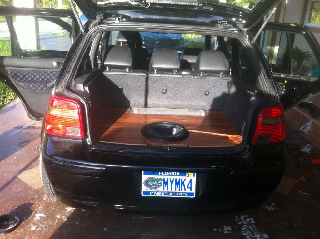

This car is still my daily driver as I commute to and from school 400 miles away about bi weekly on it.. This is how it looked up until the other day before I chopped it up.
