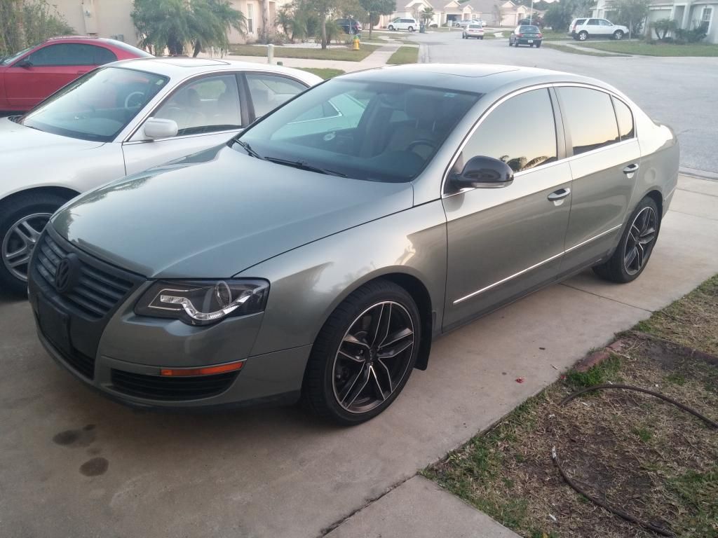

Hey guys im planning a cross country road trip this summer from florida to san francisco, California and i wanted to know what you guys suggest i should do to prep my beautiful 2006 passat 2.0T for this trip
My car has around 120K miles on it but its been maintained pretty well, i just put on new shoes on her so she should be fine there, new Forge WINtake installed as well.
