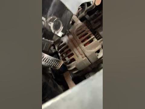

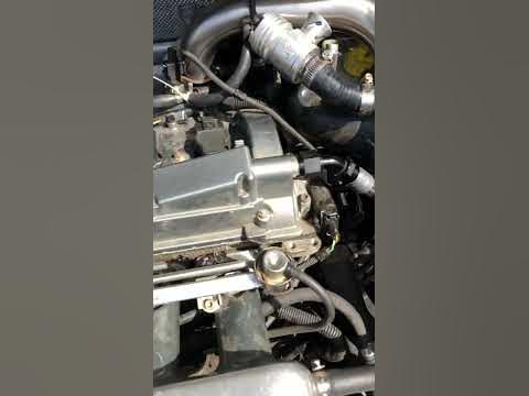

Hello all,
I have a 2002 Jetta 1.8t. Since purchasing it, I've been hearing a knocking/ticking sound that seems to be coming from the top end of the engine.
I recently dropped the oil pan to take a look at the oil pickup. Sure enough, the pickup was clogged with some sort of plastic debris.
While cleaning out the oil pan, I found some deposits of metallic sludgy material in the corners - It was very goopy and also magnetic.
I replaced the pickup itself and the oil pump and put the pan back on.
After filling with oil and starting the car, the ticking sound was still present. I am running out of ideas on where to look next.
I will try to attach a photo of my findings in the oil pan, and a video of the sound.
Any guidance would be greatly appreciated.

I watched the videos op posted. Some of the ticking sounds like normal injector noise. The rattle/knocking sounds like a loose accessory pully like power steering/ac clutch/altonator or a rod knock. Lifters/head noises seem to sound more drastic and loud than rattle/knocking in the video.
Do a compression test. Using a stethoscope like @fat biker biker stated would help as well. Hopefully you dodged a bullet because the debris in the oil pan says your motor has probably sustained some damage.

The plastic looks like the chain guides for the cam chain tensioner. There's a guide on the top and bottom.
Check if there are scratch marks above the cam chain on the bottom of the valve cover. If so, you probably have chain slap and the tensioner needs to be replaced.
