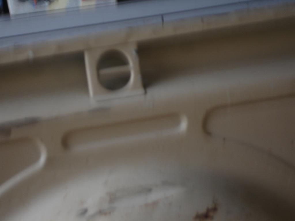

I love the built in hold down ties in the bed. 1983 ONLY???

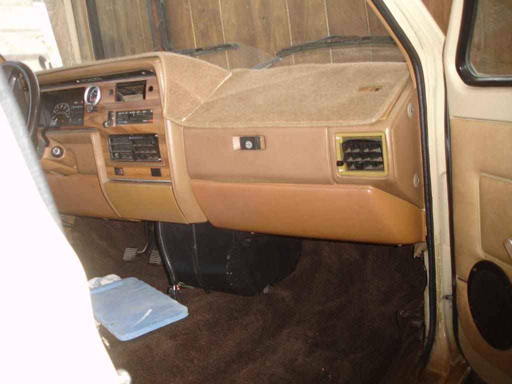

LX wood grain dash with added backlit tach., picture is obviously PRE S-1 Scirocco 3 spoke wheel & pioneer system install, Cabriolet center console & gauges. Little upgrades like intermittant wipers, lights on/key off buzzer, recalibrated speedometer to GPS. better pictures soon to come

Raunchy carpet... you're outta here. New makes a huge differance. Pictures to come
