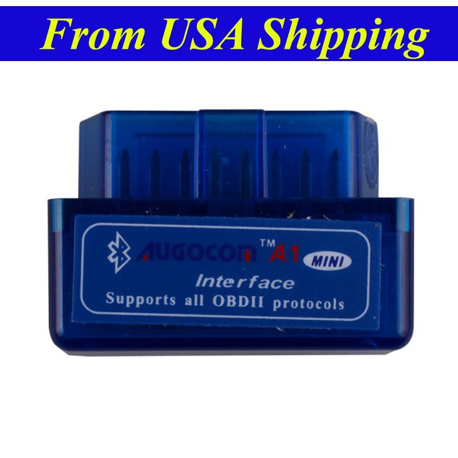

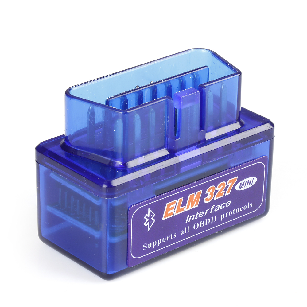

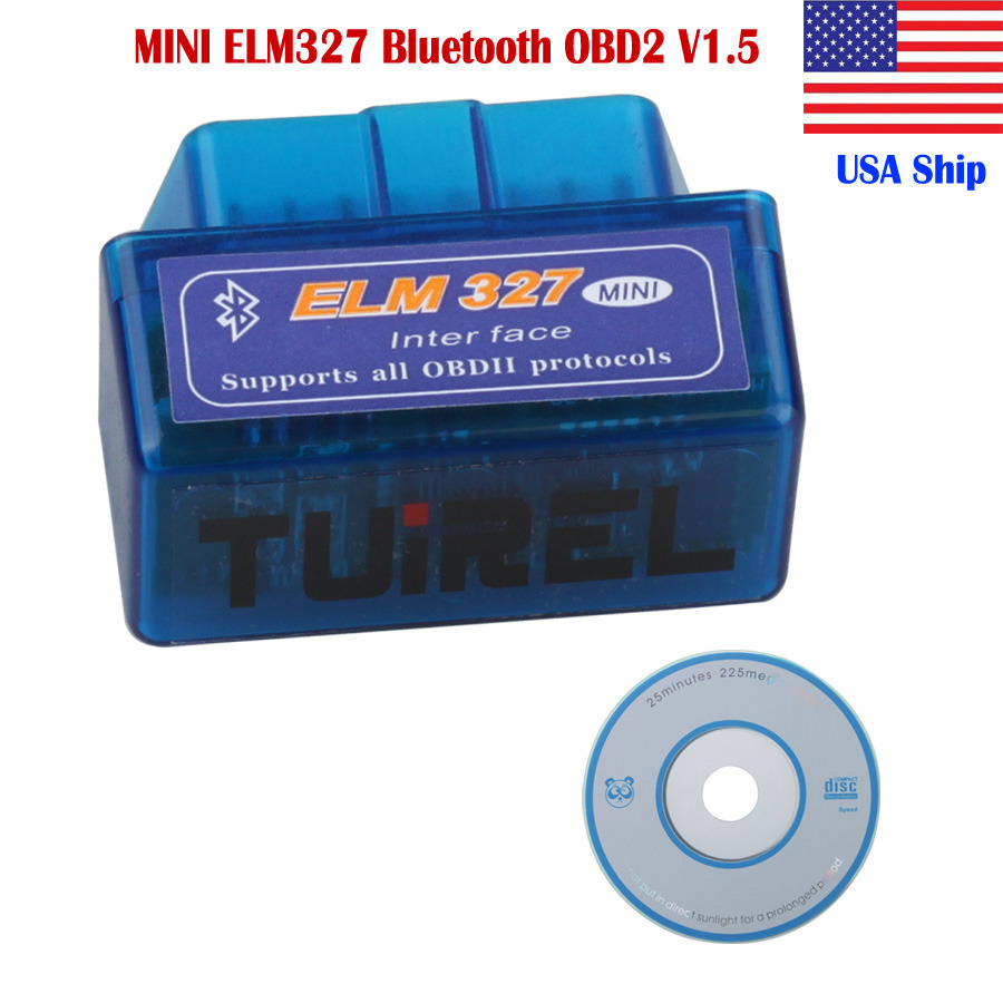

This is a list of adapters that you should NOT waste your money on
1. $7 shipped (BT) ELM 327 MINI
2. $4 shipped (BT) TUiREL
3. $5 shipped (BT) AUGOCOM A1
4. $7 shipped (BT) NEWNOW OBDII MINI
5. $7 shipped (BT) ELM327 INTERFACE (advertised as being BT + WiFi but is only BT)
