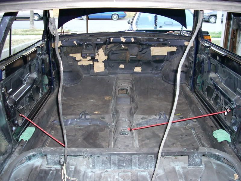

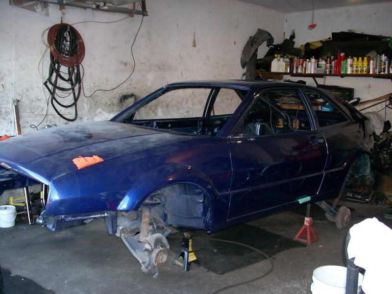

Ok some of you know that i was building a 3.6L vr6 6 speed well heres my thred. Ill be covering the myths and facts on this build. I will try to post pics when ever i can. This build will cover building my car from the ground up. Feel free to add insight but lets keep this thread clean and open for all ,tks.
Lets start i just got my corrado back from the paint shop
i have a 3.6L engine complete from a 2007 passat and a 02m 6 speed from a jetta gli 24v vr6 ...............to be continued
