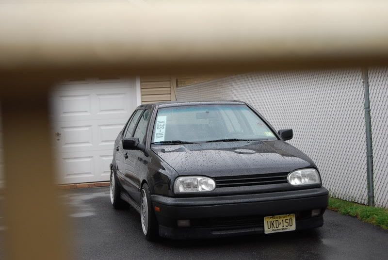

ps great shot of your car...using the white picket foreground...looks like a secret weapon!
