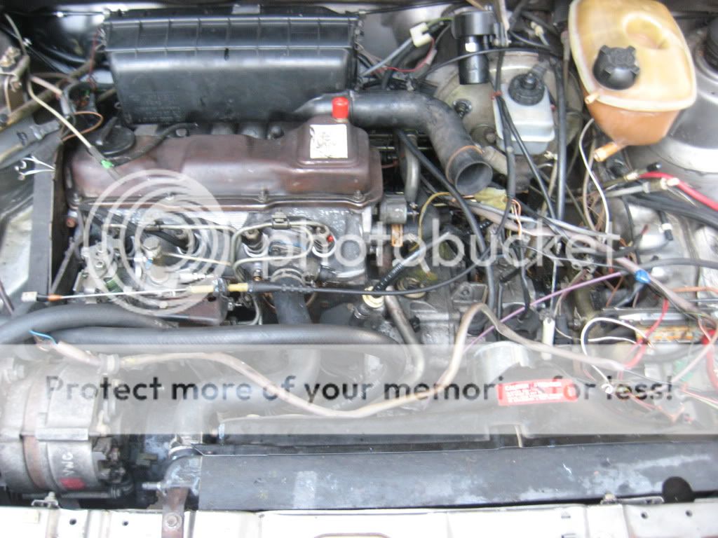

All of this gasoline wiring will not be used. I have to neatly tuck it away:
I really do not like fixing other people's hack wiring jobs...including the factory.

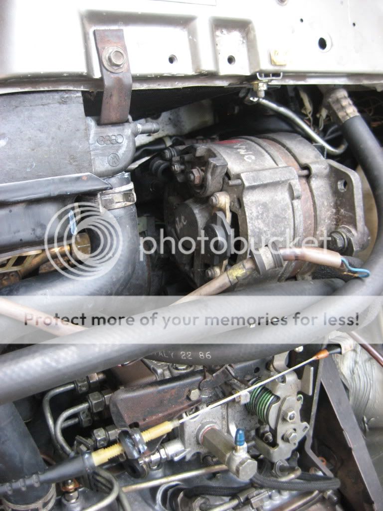

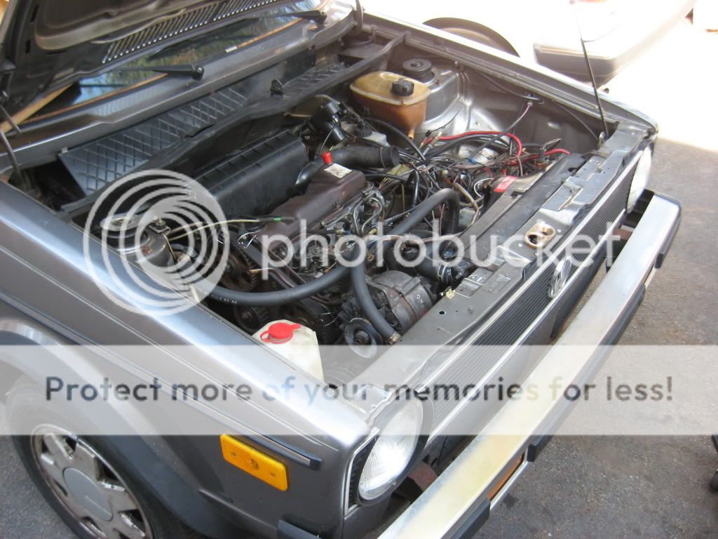

Here are my updates. Y'all that are planning on doing this swap: GET TO IT!
Catalytic converter issue settled. Took off the flanges and welded them to a 2.5" stainless steel tube bypass and made some gaskets with high temp gasket material. Pretty straight-forward.
I also finished the glow plug wiring with an OEM relay. I just need to trouble shoot it (the timer circuit is not working and the relay is staying on constantly). After I do this, I have to tackle the fuel pump issue. Honestly, I don't even know what all this stuff is on the gasoline engine (look at pics). Not sure what needs to go.

I haven't made the decision yet what to do with all that mess by the tank, either. I think a full deletion is in order! Diesel doesn't need any of that high pressure stuff anyways.
