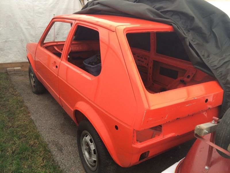

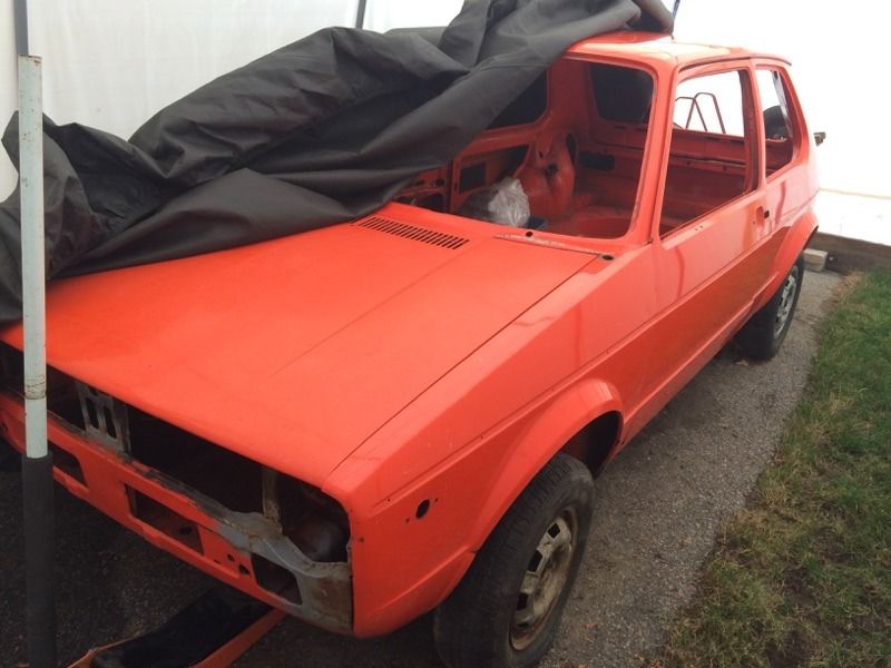

This beauty has original paint and floors, very solid, it came form Washington and by the looks of it must have been garage kept, I believe it has 55K Miles on it.
At some point it was in an accident on the front drivers corner, someone replaced the front inner fender and part of the Rad support, the job was done solid but not finished very nice.
So here is my challenge of putting it all back together :D
I am hoping this will only take a couple months...big task ahead.
Here is how she came to me.

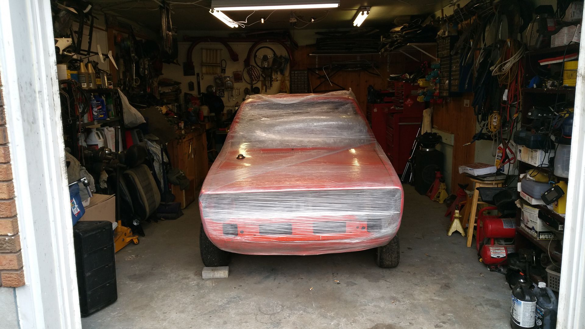

After a lengthy interview with the previous owner he entrusted me with this task and we loaded all the parts into the cabin and a few days later I had it shipped to it's new home.
He gave it a proper send of and wrapped it up very nicely!
Safely in the womb to be reborn ;)
