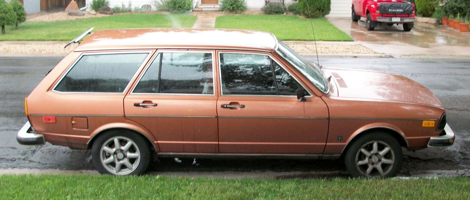

Well, since I didn't have the parts I needed to work on the Jetta in the shop yesterday, after finishing welding up the trophies for the upcoming DATR show, I started in on the suspension of the Fox. The rear is easier (no change in alignment, no spring compressor needed) so I did that first.
Since this is a B1, in addition to a wagon, there are no off-the-shelf lowering parts to buy. Its hard to find stock parts! So, I decided I would start by cutting the springs a bit to stiffen and lower it so it is better to drive and see if there are any clearance problems, etc that crop up before going lower, and possibly getting some even stiffer springs.

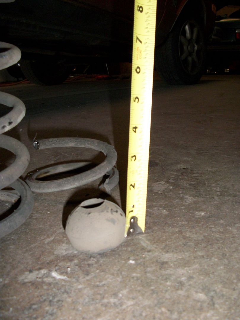

Stock spring next to the cut one, closeups on height measurements.
Stock:
1.5 Coils cut off:
Well, the rubber snubber should probably be shortened since I was lowering it, so I cut off about 1.5", as I figured that would be a good place to start.
Stock snubber:
Cut snubber:
Piece cut off:
Bolted everything back together, dropped it down and it sits about 1.5-2" lower, though doesn't look 'low' compared to most lowered cars. Good start, though and will give me a chance to drive it and see.
