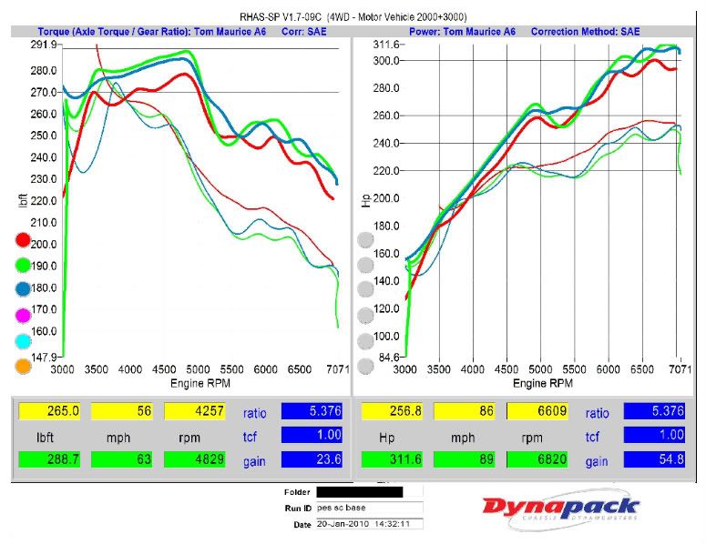

312 whp
290 wtq
The supercharged 2003 audi s6 made 70whp over stock. Keep in mind that this stage 1 kit does not have intercoolers, thus having mild programming. With the addition of intercoolers and more aggressive programming more power is attainable. The thin plots on the dyno chart below are the baseline runs prior to the install. The solid plots are after the supercharger install.
