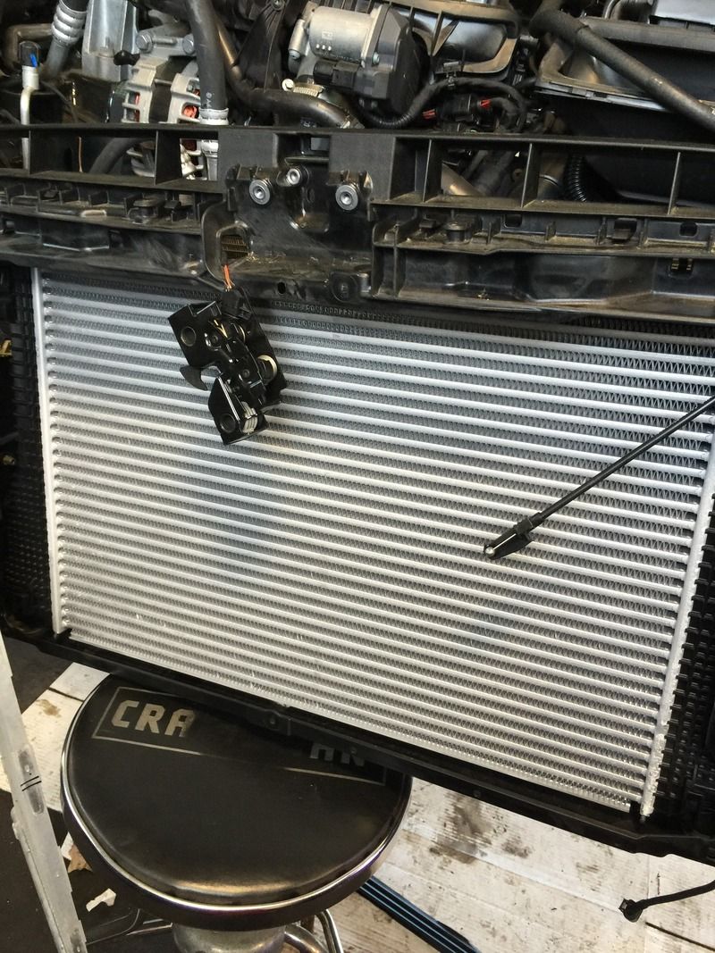

First I'll start with the intercooler. I got it shipped out from AWE and it's a stock S3 intercooler. It fits the GTI without any modification whatsoever but it has more volume to bring in more air. The box was super light (as was the cooler) but it was as advertised. Me and my boys were able to install it in just under 2 hours when we had it up on the lift. Was very easy but there are so many torque screws it can get annoying. Here are a few pictures of what we did.

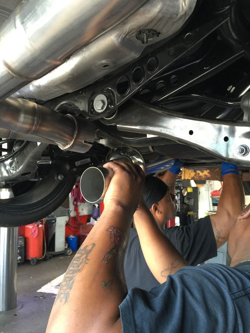

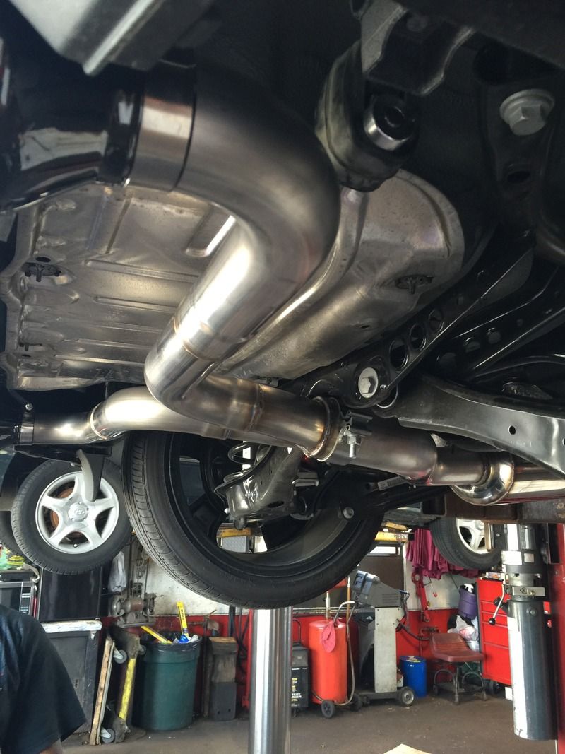

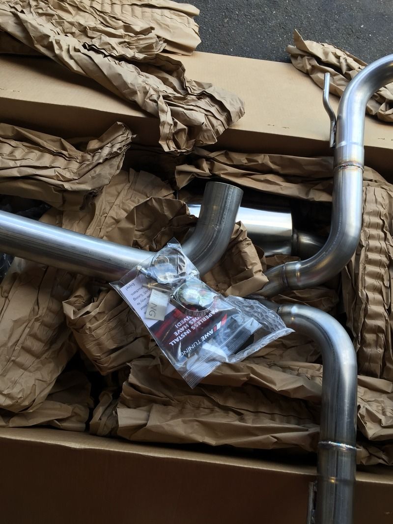

Next up was the Touring exhaust with black muffler tips. It arrived in a 35lb box and looked sick just opening it. I ordered the Touring one because I heard it was alot quieter than the other one that they make so I was excited to get it installed. Up on the lift installing it took us about 30 mins. All the pieces fit together and are held with Clampco clamps. We checked it and there were no leaks and it all fit well aside from one piece we had to mallet. Check the pics:

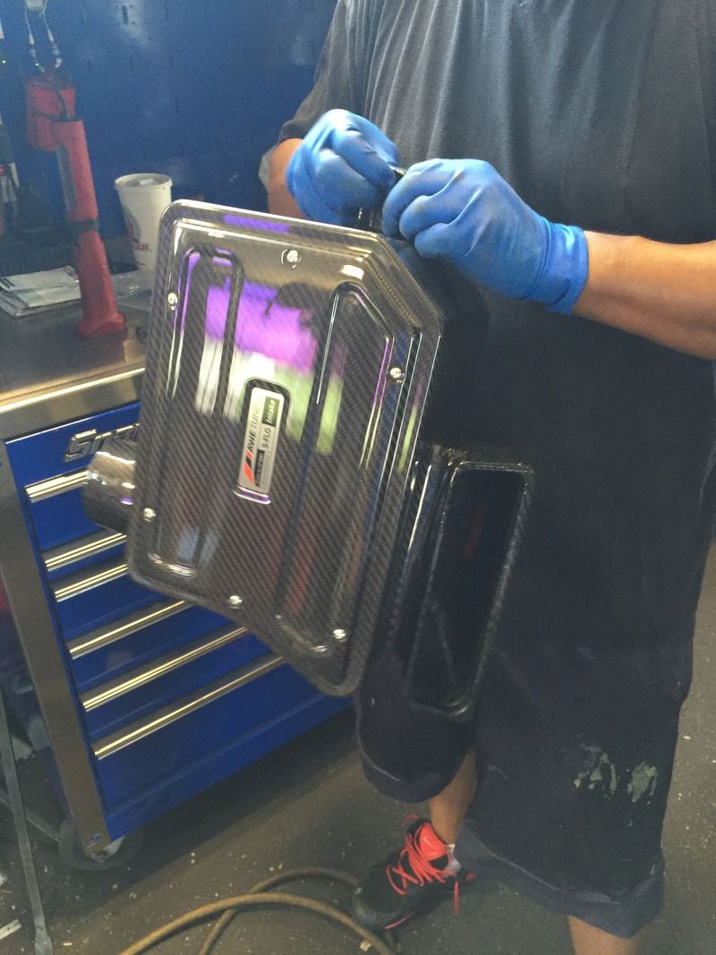

Last thing we did was the intake. It's so light and was quickly installed. The old airbox came out quickly and the new intake was in after about 5-10 minutes.

Great post and results. With the variable valve timing on both cams with the gen 3 EA888 motor it's easy to get drone when adding an exhaust system so be thankful that isn't there with the AWE system. You would have had to measure your before/after intake air temps to see the IC upgrade do its job, mine dropped 15-20*F so it works. And for those doing the R/S3 FMIC install, do not undo the hood latch cable like they did it in these pics as it's much harder and you can easily damage the wires that way, there is a factory disconnect located just above the drivers side headlight that is supposed to be used when taking off the front end.

So is the IC in front of the radiator? I just had some front end damage and it seemed like the radiator was in front when I saw the brownish/red fluid pouring out of it. Wondering if I should try to sneak an upgrade here...
