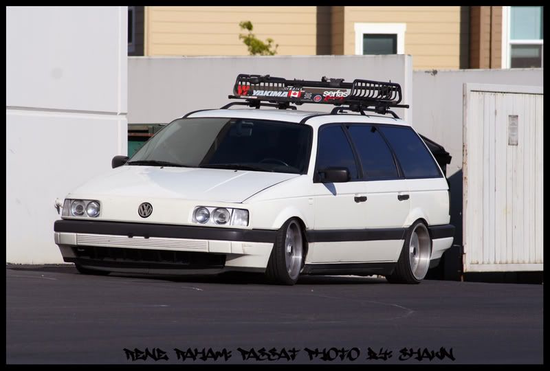

16x9 et10 in the back
(pretend it doesnt have any camber, it may poke a bit)

I dont have any good angles for the front but you can get an idea with these two

Where are you comming up with these crazy offsets? Type A's are 16x9 et 15 and 16x7.5 et 20.Ive never seen a set in the offsets you are talking about. The white car you posted has the offsets i just posted so et 0 up front will look retarded.
