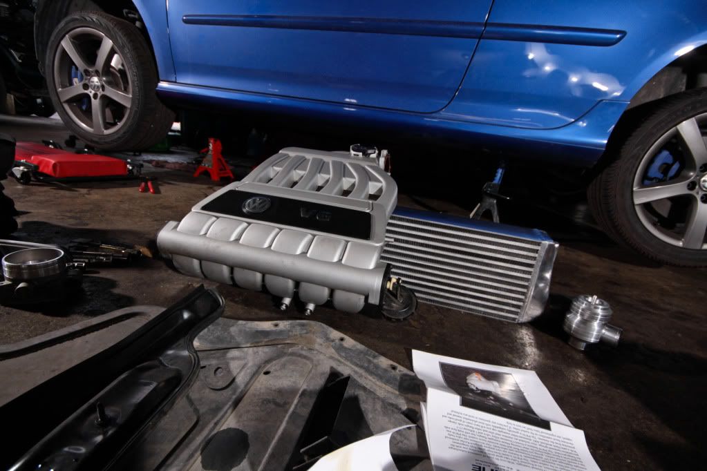

Here it is. Starting this build thread. Like i was saying, it will be a short build. I don't have a ton of pictures like I would have gotten but this IS what i DO have. I will be posting new photos every other day or so...
We were contacted by a customer from out of state not too long ago who wanted to Turbocharge their car through us. The customer ended up shipping the car from Maine to C2Motorsports in Louisville, KY. The entire build was done on location. We do offer shipping deals for cars worked on location here in Louisville. ;)
MK V R32 Turbo
Here is a list of the parts that went into it:
This is a C2Motorsports manufactured turbo kit.
Turbo Hardware
R32 Cast Turbo Manifold
SS Downpipe
3” Hi-Flow cat w/SS midpipe
Precision BB Turbo
Installation Hardware
WG hardware kit
(4) 3/8 x 24 studs
(4) 3/8 lock nuts
(14) copper nuts
FMIC
8 x 22 x 3.5 FMIC
2” IC tubing: 45° w/long leg
2” IC tubing: 45° w/short leg
2.5” IC tubing: 90° “L” bend
2.5” IC tubing: 90° “S” bend
2.5” IC intake to TB
Intake w/4” MAF
Silicone
2” 90° elbow (use for 2” x 2” coupler)
2” x 2.5” reducer
2.5” coupler
3” 45° elbow
2.5” 90° elbow (use for 2.5” x 2” coupler)
3” x 3.25” reducer
1.5” 90° elbow
Gaskets
(2) Exhaust manifold
T4 turbo gasket
38mm waste gate gasket
Clamps
1 - 3” V-Band
5 - 2” SS hose clamp
7 - 2.5” SS hose clamp
3 - 3” SS hose clamp
1 - 3.25” SS hose clamp
4 - 1.5” SS hose clamp
1 - 3” SS band clamp
1 - 2.5” SS band clamp
Hoses
7mm x 3’ vac line
5mm x 3’ vac line
3’ – 5/8” hose
1’ – 3/4” hose
Lines/Fittings
Oil return: AN10 x 18”
Oil feed: AN4 x 48”
Oil return fitting w/gasket
AN10 Weld fitting (oil pan)
AN4 male/female 90° swivel (oil feed at turbo)
#10 x 1.5 nut (FMIC out pipe to bumper stud)
M10 x AN4 male (oil feed at filter housing)
1/8” NPT x AN4 male (oil feed at turbo)
Lines/Fittings Hardware
38mm waste gate
38mm waste gate elbow
Forge diverter valve
6 - Bosch Fuel Injectors
6 - Injector harness
R32 SS Head Spacer
R32 Head Studs
4” air filter
PCV manifold plug
2’ - Fireflex (black)
2’ – Silverflex Heat
