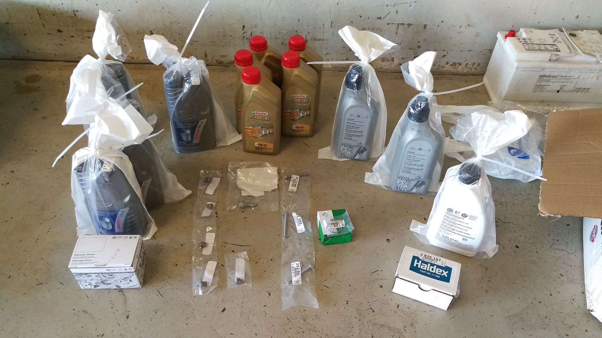

The parts were kindly supplied by ECS Tuning...

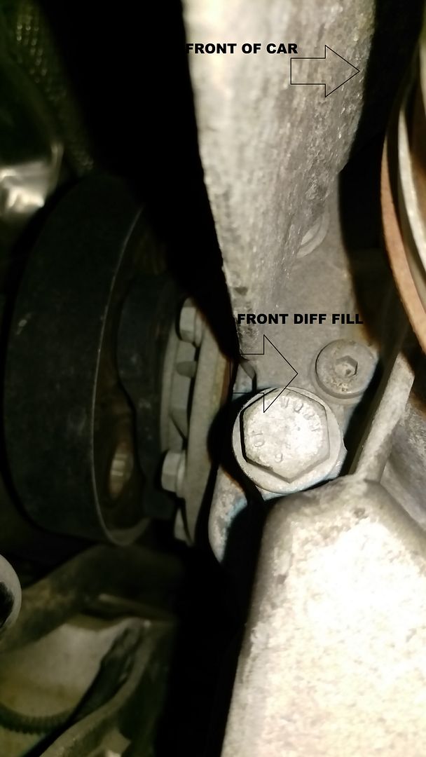

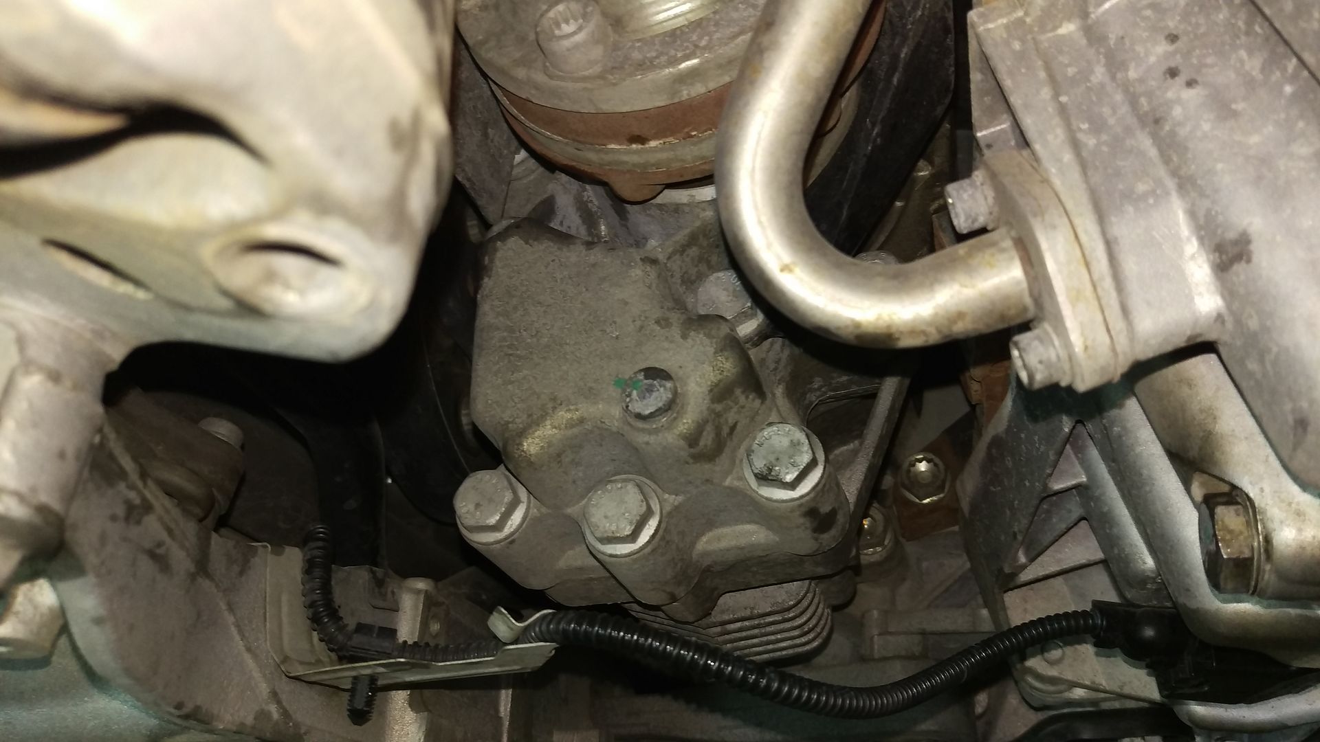

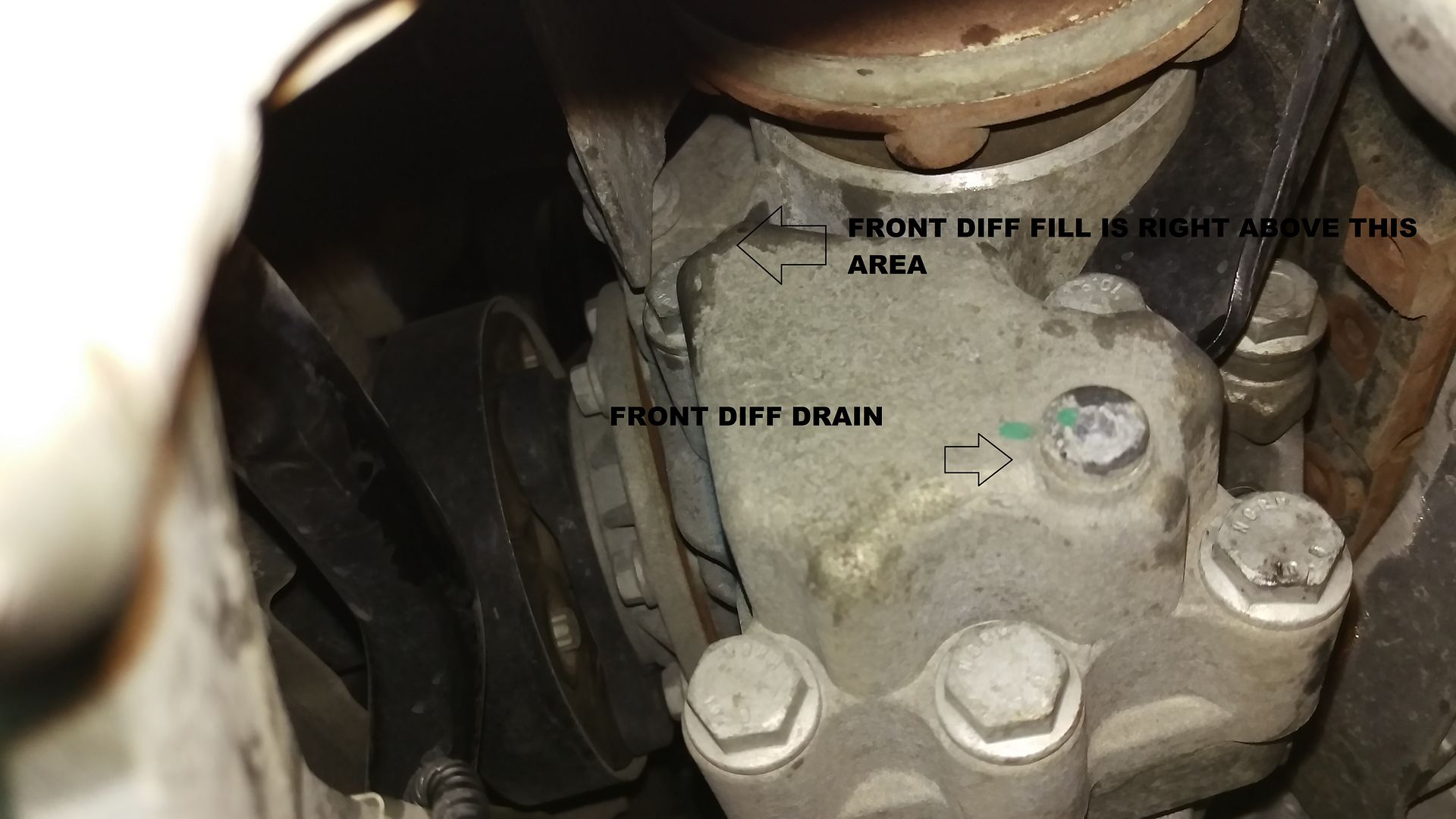

FRONT DIFF:
So as you can see in the pics the front diff fill bolt is hidden on your 11 o clock position and not 1 o clock (on a DSG car) as previously stated by another forum member...For this job you will need one of these http://www.ecstuning.com/ES2765922/ THE FRONT DIFF WILL TAKE ALMOST THE COMPLETE BOTTLE SO MAKE SURE YOU KEEP PUMPING FLUID IN THERE....
Front diff...

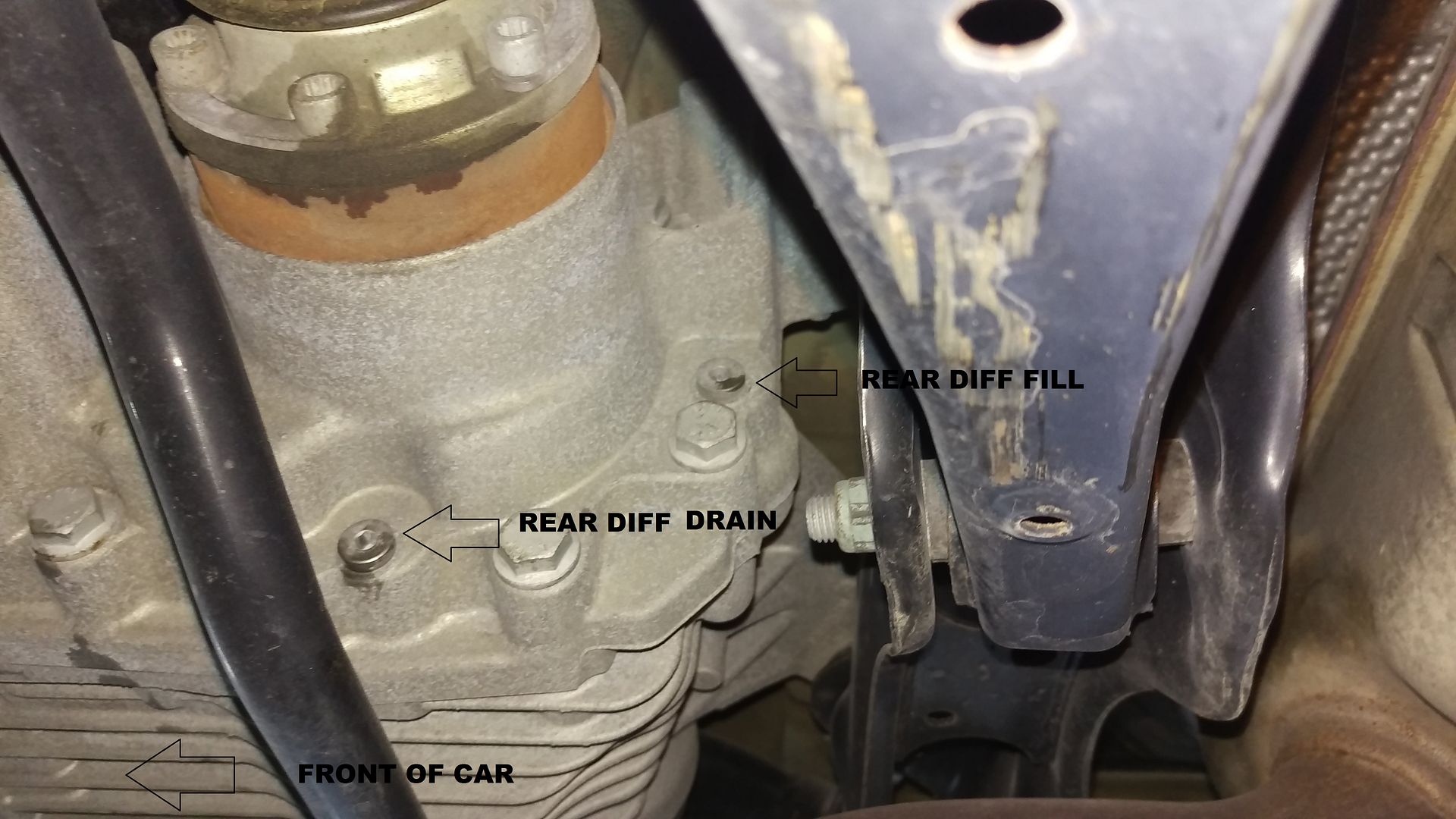

REAR DIFF:
The rear diff fluid swap was quiet easy....For this job you will need one of these http://www.ecstuning.com/ES2765922/

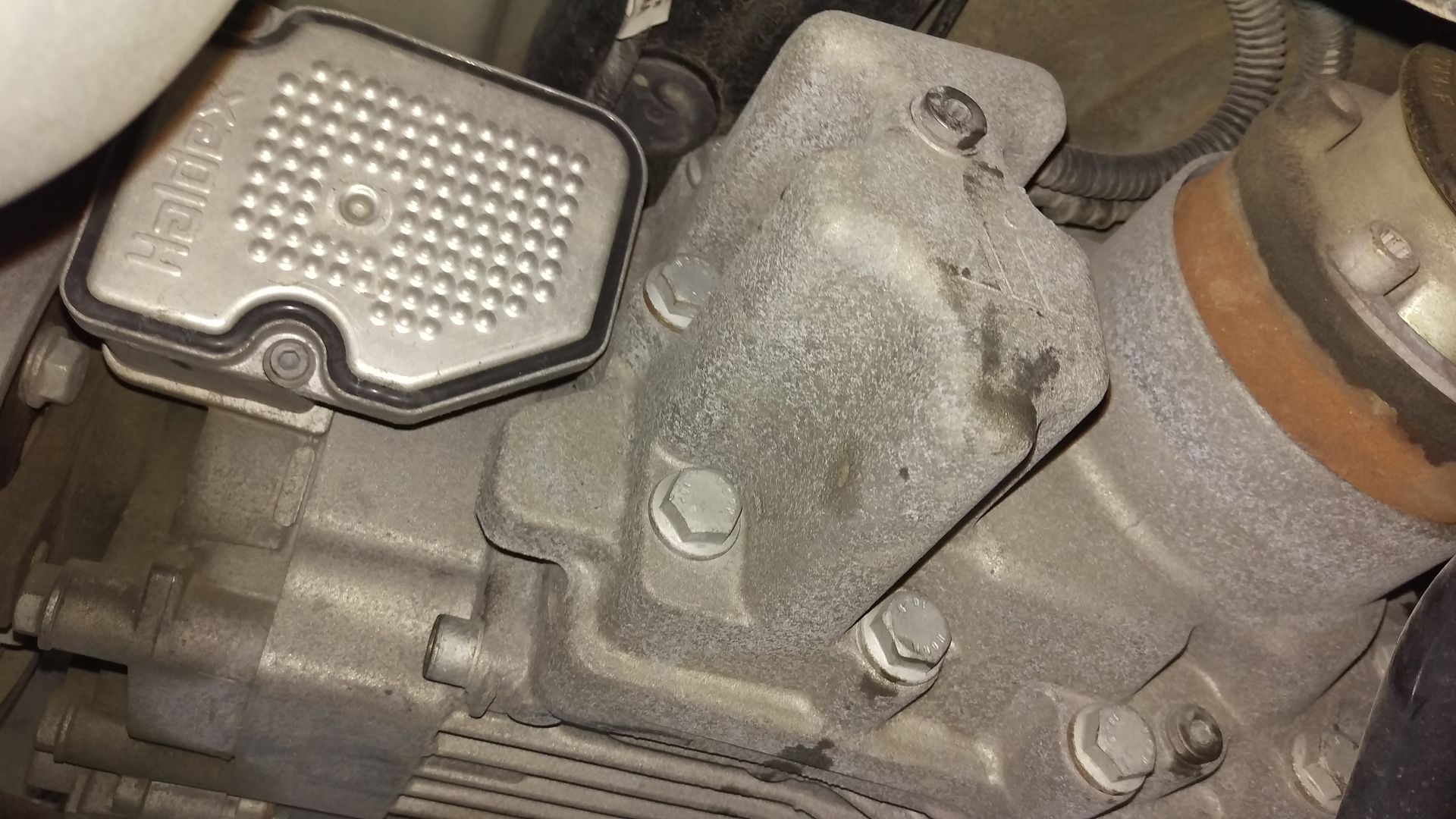

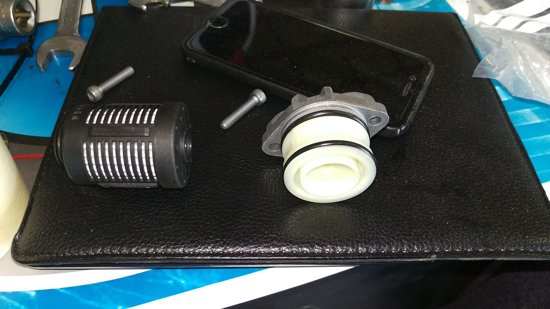

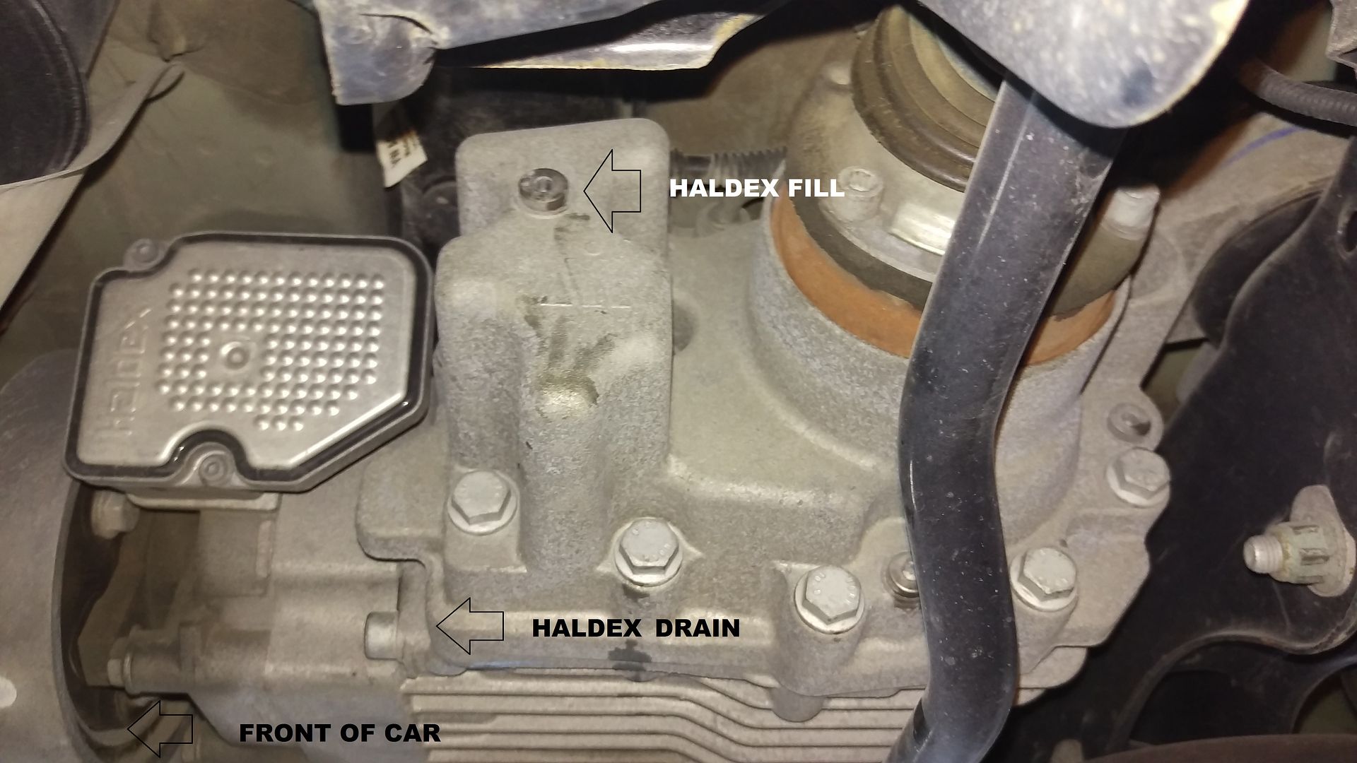

HALDEX:
The Haldex Fluid swap will require this kit http://www.ecstuning.com/ES2827153/ which includes the OEM Fliter and cover and Fluid....
To get the filter out it was very hard due to lack of space. It was stuck in there. We had to mangle it destroy it to take it out. Here are the new parts from ECS....
When it came time to fill the HALDEX up with fresh fluid it was quiet a fiddly job as the fluid kept coming out of the fill hole. Just had to put the fill pipe in a bit deeper and at an angle and then it gulped up most of the Haldex Fluid in the bottle.

For this you will require 5 x http://www.ecstuning.com/ES12023/ + 1 of http://www.ecstuning.com/Volkswagen-Golf_VI--2.0T/ES2771687/ + http://www.ecstuning.com/Volkswagen-Golf_VI--2.0T/Drivetrain/DSG_Transmission/ES2662718/
OR http://www.ecstuning.com/Volkswagen-Golf_VI--2.0T/Drivetrain/DSG_Transmission/ES2739753/ (it comes with 6 liters but usually you only need about 5)

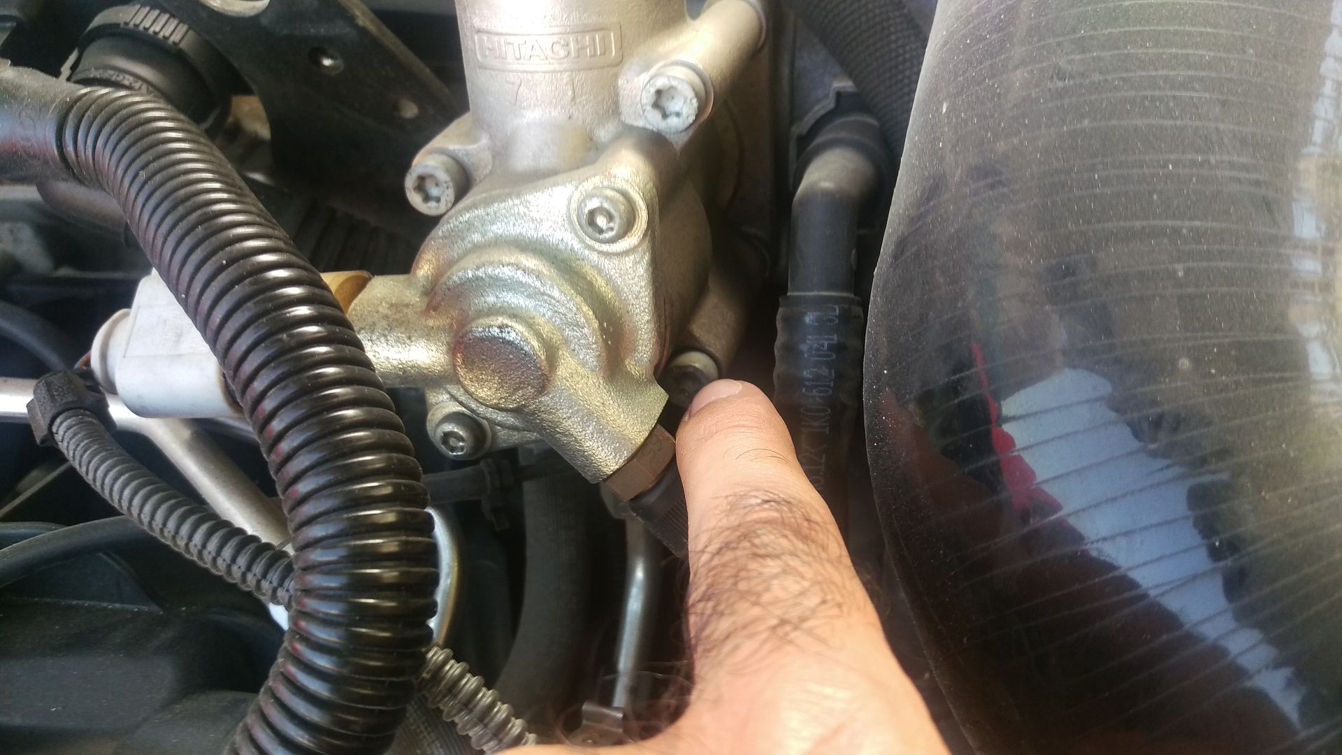

So i had my Cam follower changed at the dealership last year and recently i was starting to hear a knocking sound upon start up and idle. On further investigation i noticed the cam follower bolts were only hand tight....
I purchased this kit from ECS http://www.ecstuning.com/Volkswagen-Golf_R--2.0T/Engine/Fuel/ES2609354/ and proceeded to swap out the old cam follower and O ring. Thank God there was no damage to the previous follower from the loose HPFP bolts.

What is interesting is that when I was working with [email protected] to get a massive maintenance order in for my 80k service he mentioned that I did not need a haldex filter because it was not a serviceable item, maybe that is why you had to destroy the old one?
767 Posts
Discussion Starter · #3 ·
Nice, thanks:beer:
It was jammed up in there. You really should change it while your there. No harm.

I do have a question. On the diffs and haldex fluid, do you fill it up until it comes out of the fill hole? Sorry for the dumb question. I assume you used a fluid transfer pump to get the fluids in the odd holes?

Yes to both of your questions :)

I have a couple quick questions. What did you use to get the fluid into the fill holes? I normally use something like this (http://www.harborfreight.com/multi-use-transfer-pump-66418.html) for these kinds of jobs but want to make sure I grab something else if there's a better tool for the job here.
Also, the part about destroying the old Haldex filter is a bit disturbing. Did you use something like a screw driver or pliers to pull the older filter out? Is there potential to have pieces of the old filter become lodged into the Haldex system by doing this?
Again, thanks for posting this DIY for everyone.
That tool from harbor freight should do the job, we used a tool sort of like a big brake bleeder thingy (cant find the right words) and it gets pressurized by using an airline from the shop and then you can easily pupm into the diffs/haldex/gearbox etc......
Dont worry too much about trying to get the Haldex filter out, we mangled it and squished it from the center so it was easy to pull out after as it was locked in there (we used needle nose pliers due to lack of space). No pieces fell off of it at all so it was all good. Just be careful when you try to remove it. Take your time.

Big thanks for following through and posting this.. great write up and pics. Puts a lot of the questions and inconsistent info from that older thread to bed. I now understand why there was conflicting info on Haldex filter... it seems it's possible to service it, but not necessarily intended to work that way.
767 Posts
Discussion Starter · #9 ·
Yeah, I would replace that filter every say 60-100k? Up to the vehicle owner. its not too expensive or difficult of a job.
When you pulled the pump to change the follower did you notice any metal on the bolts? The housing the pump bolts to is soft aluminum and you can strip the threads very easy which will let the bolts come lose. You should watch them to make sure that this is not the case on why they came lose.
767 Posts
Discussion Starter · #14 ·
Yeah I checked for the striped threads. It looked good. That is why I just tightened them gently and I'll keep an eye on them.

I forgot to ask, when you took the Haldex filter out, does any fluid come out with this? Should you swap the filter with the Haldex fluid drained or does it not really matter?
Just a little bit. drain the haldex, change filter, put in new haldex fluid
240 Posts
What did you end up using for diff fluid? For the Haldex fluid fill I found a larger syringe and catheter (or tubing that fits on the syringe) from a pharmacy works well. Fill from the qt of fluid via the syringe and tube and squirt it into the fill hole and repeat a few times. You can plug the fill hole with a finger while filling if it's weeping out.
One thing to consider after I filled the Haldex and it started running out, the next day I had the rear on ramps to do a brake fluid change and on a whim checked the Haldex level. It needed another couple syringes worth of fluid. It must settle deep in the gears and crannies after driving.
