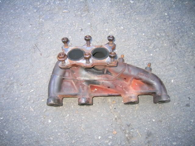

Soo.. I have an extra dual outlet mani and was wondering if i could just hack off the flange and weld on a T3 one?
Or am i just better off spending the $$ for a cast mani..?
Manifold in quiestion..
See less See more

better yet just flip it upside down like you have it int the pic. Make a adapter and your set. You will have to make the adapter angled forward.
ive seen adapters like zornig described made to do just that on a few japanese cars. seems like they work, and pretty damn well too.
-j
Re: Can I make a turbo manifold out of the dual outlet mani? (Satur9)
I have seen it done, and it was like Zornig described. (Flipped over).
However, I would definitely avoid welding cast iron at all costs. You can make a nice mild steel adapter faily easily.
Good luck!
Hmm... Wouldnt making an adaptor mess up the exhaust flow thou? I mean, joining 2 ports into 1 with in an inch or so?
Hmm
Re: (Satur9)
Not if you make it transitional. Use a flange with two holes, and use two weld-els to make a merge collector. Done! http://****************.com/smile/emthup.gif

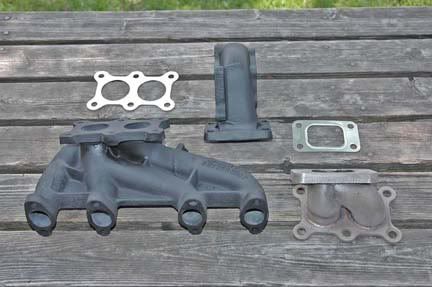

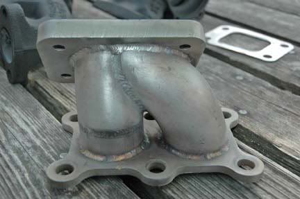

yup it works greats actually...this setup is on my bunny and the same adapter works on a mk2...
all together...
and on the bunny...
credit goes to blackmk2 on the tex for design of the flange/adapter
See less See more

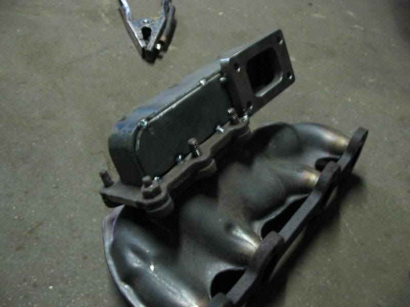

I had this exact works fine as long as the person welding it know what there doing cheap and great for a ABA xflow heres the one I had .
See less See more

Where did you get the dual outlet flange to make the adaptor piece?
Quote, originally posted by DubSTYLE »
See less See more
knowing the guy wo made it, he likely sat down with some calipers, measured it up, cad'd it and then had it laser or water cut
Re: (Tire_Marx)
U good sir are correct! http://****************.com/smile/emthup.gif
See less See more
