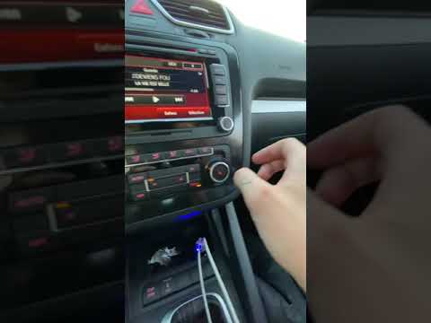

The « wheels » where you can select the temperature stopped working gradually, at first it was just a bug, but ever since, it worked less and less. Here’s a link so that you can see what I mean :
As you can see, I need to turn the wheels brutally so the temperature can change.
