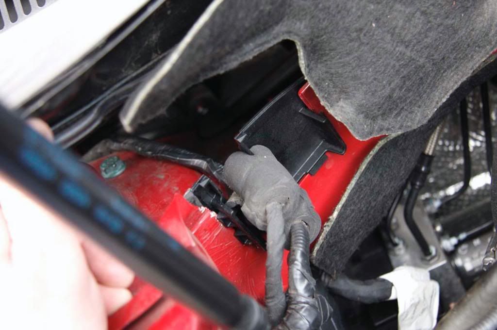

Here's some pictures to help out with the firewall gasket. The pictures almost say it all.
First, get the parts together

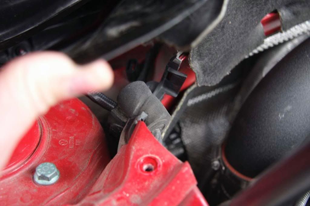

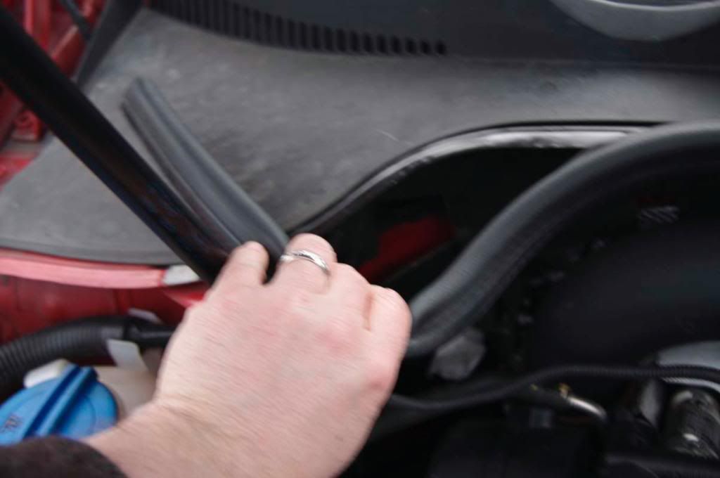

Then remove the foam block on the left side of the rain tray, then pull rubber seal away from rain tray.

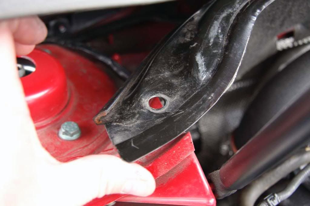

Remove the bolt that sits here (10mm if i remember correctly), pull it up enough to get to the firewall gasket.

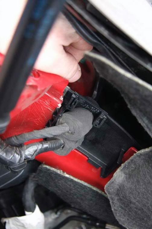

It's easiest to rotate the old firewall gasket to get it free of the wiring harness.
Frisbee maybe?

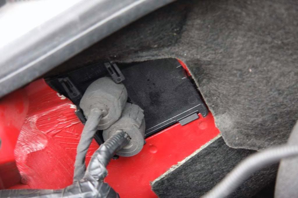

Insert new firewall gasket in the reverse manner as you removed the old one.
Make sure to put your wiring harness back snugly into the slot.

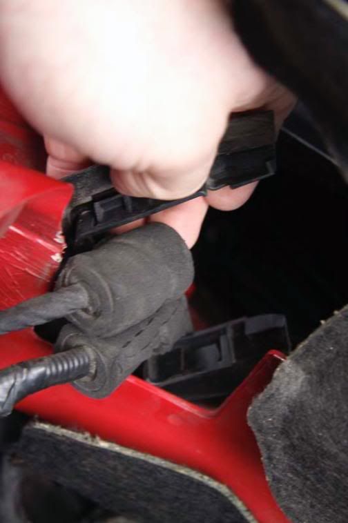

Now, push the clip into place.
Oh Billy! Noise pipe free!
