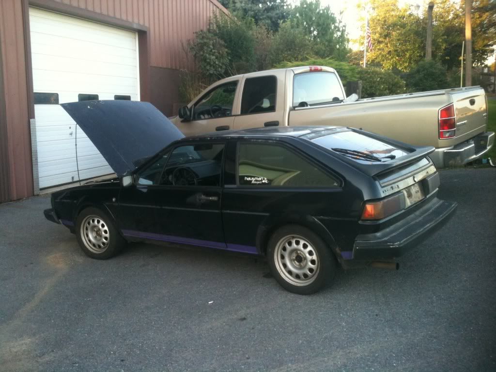

THE VICTIM

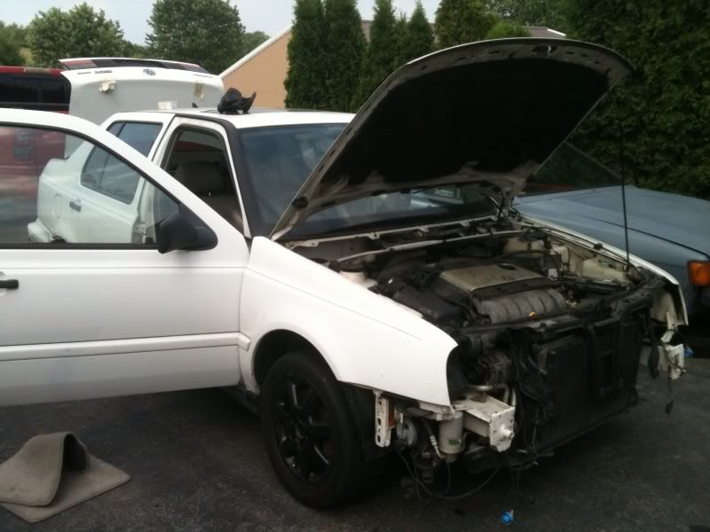

THE DONAR
NOW THE DONAR WAS CUT UP AND PULLED EVERYTHINGS THIS PAST SUMMER
The past couple weeks in my spare time ive been sanding and fixing and lookin for rot, it will get a proper paint job and a mild shave and seam welds once motor is in and running. meaning yes, i am going to pull it back out and strip the car down.

As it sits as of now
While waiting for my gf to show up tonight to fix her cabrio, i began pullin the 1.8 tonight and the wiring was all cut and a rats nest, no wonder the battery kept draining:facepalm:
