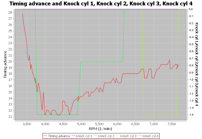

Farting around on Nefmoto I decided to download ECUxPlot.
Now you can graph your logs instantly without issue with Maestro Hi-Speed Logs.
Download ECUxPlot HERE
Click 'Open File'
Load your log data as usual, select your data points and DONE.
Or if you want to overlay logs to see the effects such as the boost curve, all you need to do is click 'Add File'

i am assuming this will also work with vcds logs?

This is super cool!
Have any of you done the power graph and matched it with your known power output to see if they correspond?
