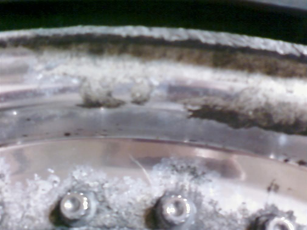

You are going to be working on the lips right now, particularly on the bends, curbs, etc. It is *IMPERATIVE* that you heat the area to be fixed very well. Keep in mind, the heat will remove any clear of paint on your wheels, and will tarnish it. So if you don't want to go through the rest of this to fix what we're doing, you might as well stop.
Anyway, heat the area with the bend, I.E, this guy...
After heating it very well (I recommend working gloves.) take your adjustable wrench, and tighten it to fit over the edge of the damaged area. From here, you will SLOWLY bend the damaged area out to be rounded like the rest of the lip. Working from the center of the damage worked for me, and then working out on both sides. Nice and round. Once you're done, you end up with a round lip...
Notice the bad curb rash, and the spots where I used the gas.

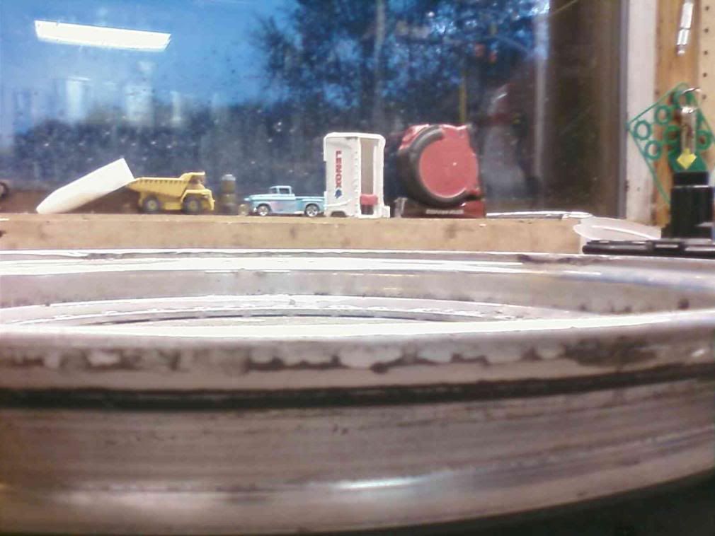

Step 6) The sander. Remember those little jagged edges I told you about? This is where you're gonna take care of those. I used 220 grit for the whole wheel, but see what works for you. This is where you'll get that nice smooth lip back. WEAR EYE PROTECTION! PIRATES ARE ONLY COOL IN THE MOVIES!
Take the disc sander, and slowly roll it over the lip edge. Your goal here is to take as little as possible off, while reshaping this lip to its former glory. Once you've hit all the rough spot, go over the whole edge with the sander, taking out all the imperfections. Once you're done, find a totally flat surface, and lay it face down, gently. This is where you'll find any low spots, or high spots. If you have a high or low spot, I found using a marker pressed under the lip where it seperates from the table worked well in identifying the problem areas. Yet again, work them out until it's perfect.
This is what a slow process will reward you...

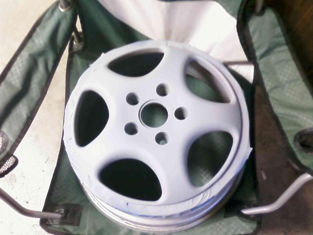

Step 9) The paint. I used Plastikote, as it's never failed me before...
I did two coats of primer, and it came out like this...
It's a sand-able primer, so give it a whack with some 1000 grit to get rid of rough areas. Next is the paint. Whatever color you want. I bought one of these...
