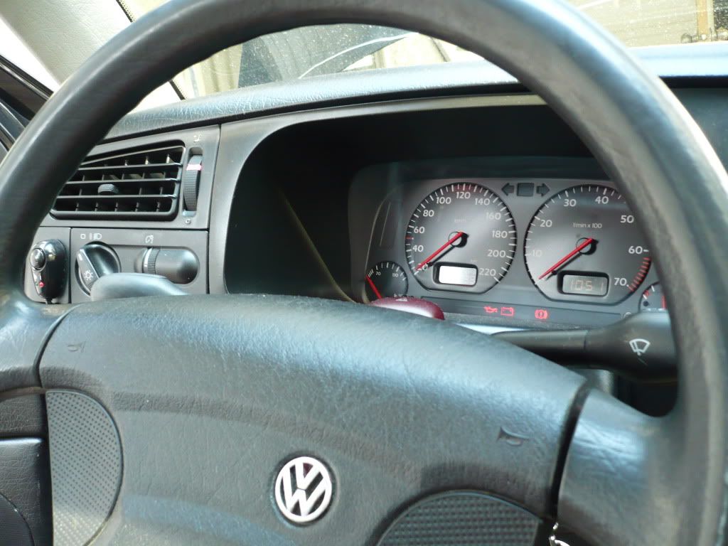

All powered up and ready to reinstall.
Installed in the car
