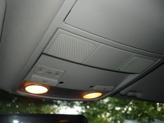

Front Dome Lights

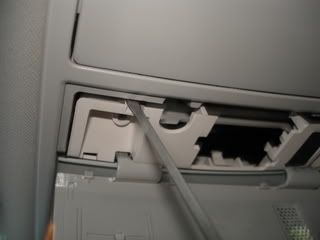

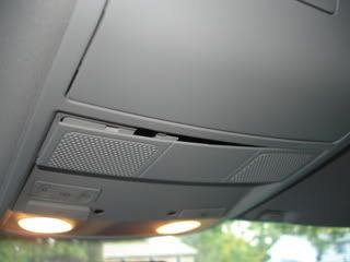

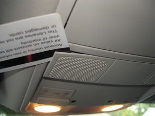

First start off by removing the panel with the small holes in it. This is done by using a credit card or an interior removal tool. Starting on the left side place the card under the corner and carefully pry it back.

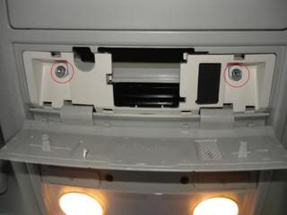

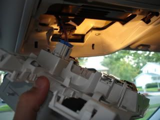

Once it releases work your way across the unit until the whole piece pops down. Now pull it towards you and down so that you have full access to the two screws. Remove these two screws.

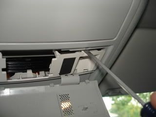

Once they are removed the unit with still stay in place. Using a small flathead screwdriver release the two tabs to free the entire unit.
Hold the unit with one hand while releasing the second tab because it will fall out.
Now, free the unit from the wire harness by squeezing the blue clip.

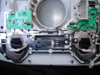

BE CAREFULL AROUND THE STOCK BULBS! THEY ARE EXTREMELY HOT! Let the unit sit around for a few minutes before proceeding so the bulbs can cool down.

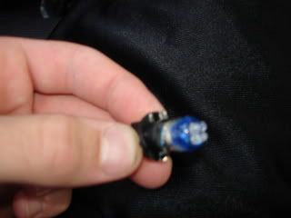

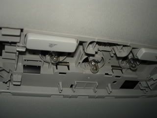

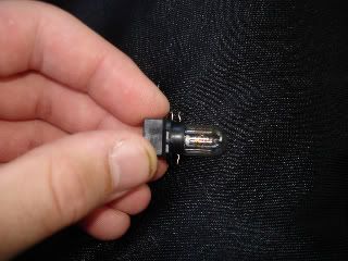

Now that the bulbs are cool proceed to remove them. This is accomplished by turning the black tabs 90 degrees and pulling outward.
Once the assembly of the light and black holster is removed proceed to pull the bulb out of the black piece.

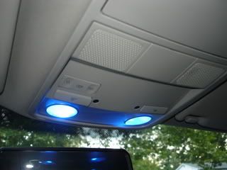

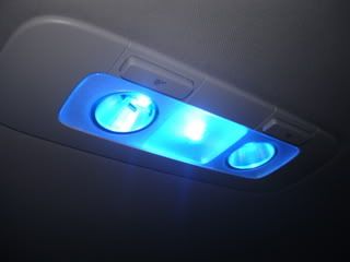

Now place the led bulb in place and reverse the entire process to reinstall the unit. BEFORE REASSEMBLING THE UNIT TEST TO SEE IF THE BULBS ILLUMINATE WHEN THE BLUE WIRE HARNESS CLIP IS INSTERTRTED. If they do not work simply take out the bulb and black holster assembly and turn the bulb around. Since LED’s are polarized they will only work if they are placed in the right way.

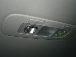

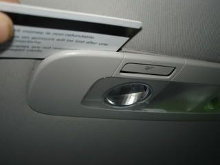

Use a credit card or interior removal tool as before and carefully pry the assembly down starting from the rear left corner.
If needed use your fingers to release the clips as you work your way around. Once the cover is removed you will have full access to the lights.

I have the white LED's in my car. I ran into a problem when installing the rears. When I had all five leds on, it would uber-dim the leds. When I took out the middle led from the rear, they worked fine.
For some reason I couldn't get all five leds to work.

I got the blues also........but from 42 Draft Designs.
I cant leave the door actuated light setting on. The bulbs stay sort of lit all the time. So its either on or off at all times
I like it. Thought it was a little rice at first but I got over it.
