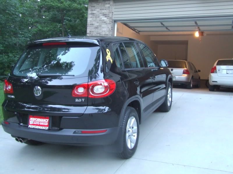

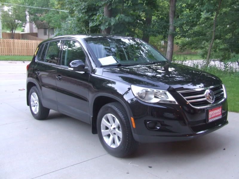

TiG's stats the day I brought her home
2009
2.0T (K03)
6 speed manual
346 Miles (was driven from CHI to Omaha so I could buy it)
