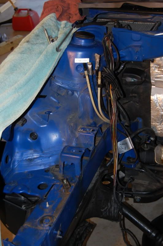

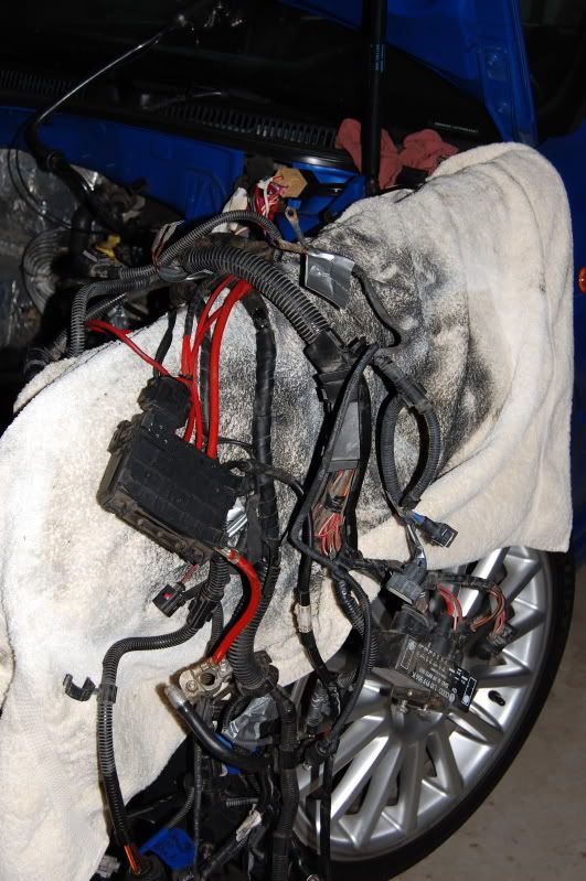

Im in the middle of bay shaving and Im to the point where I need to extend some wires. Do the gauge of wires need to be exact? I have read that some have taken a spare harness and chopped it up and others say that it needs to be exact to to resistances and such...to any that have done this much help is appreciated:thumbup:
Pics for clicks on where im at:
These have been unwrapped since the pic:
