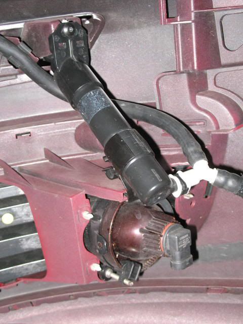

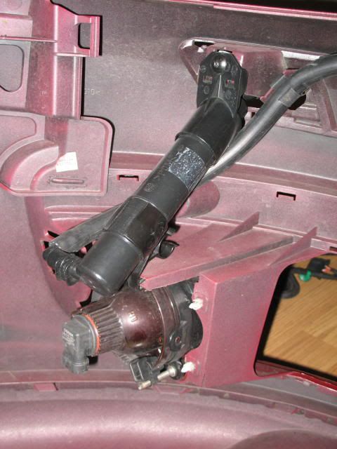

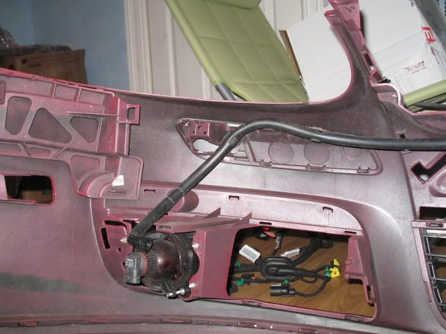

I finally enabled the headlight washers w/vag-com tonight and bled the system according to Bentley description. Last thing to do is to paint the bumper covers...

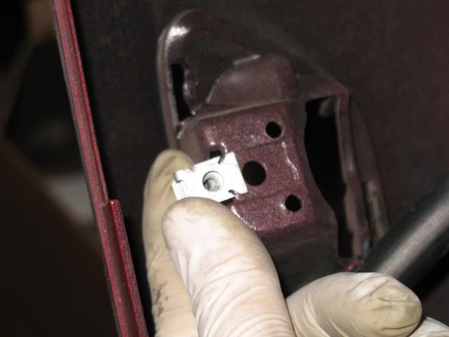

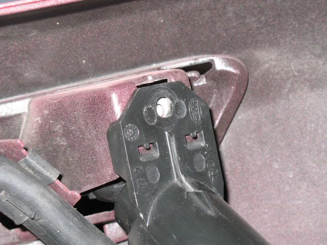

How much were all the parts and how long did it take? It doesn't look too difficult, just time consuming?

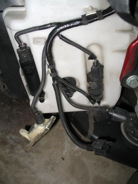

I got the whole set here for $150 or so. It is not difficult.

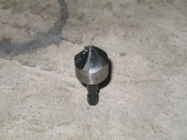

Drilling a hole in the fluid tank is a bit of pita. I took the picture of the drill/mill bit 3/4" I used. I also used flex extension between the bit and the driller. You have to use small drill first to make a driver hole.
You also have to push through the firewall one wire. I had the airbox off, so I did it on the passenger side, but you will be better off with the driver side.
And that's pretty much it.
