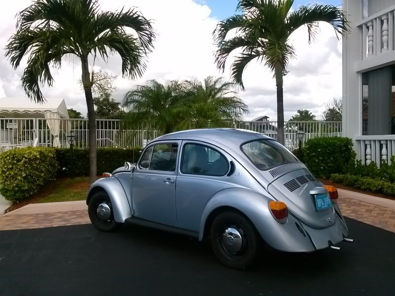

Hi all! I'm getting my first air cooled beetle this week. My mom is shipping it up for me to clean up, tune up, and see if I can sell it for her.
I don't really know much about air cooled but I am pretty mechanically inclined. I don't know much about the car either other than: it's a 74, re-upholstered interior, repainted, rebuilt engine within the last 2500 miles, and it has a little rust in a few places. Otherwise it seems like a clean car.
Do you guys think I could get $4000-$5000 for it? Or what do you think it's worth now and what would it take to get it there?

I wouldn't do anything.
The "little rust" includes rust behind the crescent vents. While this is not an uncommon problem, the paint-over where it is bubbling from the inside out did nothing to hide how far gone this is. It is not an easy fix. Paying someone to fix it would be costly.
Therefore, three types of people will buy it -- (1) someone looking for a dependable banger, (2) someone with welding skills, (3) someone who doesn't know it's a problem that keeps getting worse even if they don't see it.
Only #3 might pay $4,000-5,000 if everything else is in order.
Depending on how fast you want to sell it or how patient you can afford to be, I would ask $4,500. But be forewarned: Anyone from the first two groups will lowball you, except it is only lowballing relative to you asking $4,500.
Don't lie. Just emphasize its positive points.
Unless it's not firing on all cylinders or pulls to the one side when braking or anything else like that, don't spend any money on it because you won't get it all back. Even if something mechanically is amiss, lower your expectations rather than chase the pricey fix. At most, chase the simplest fixes like a routine tune-up, oil change, light bulb, or anything like that if necessary.
