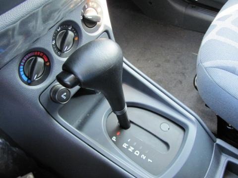

I am looking for a new vehicle for my small business that could also be used for infrequent personal use. I am also a euro ford nerd so I am thinking about a transit connect. The transit connect was only sold in the US with an automatic and a gas engine. Manual diesels are the norm overseas. I really want a manual transmission.
Does anyone know if a manual swap is doable or been done? Any hope of using Focus or Volvo S40/V50 parts? Any suggestions for research?

Focus parts, it is a C170 chassis, and an MTX-75 will bolt right up to that engine. Tranny mount and dog bone status unknown.
...and when you're done, a turbo kit from FSWerks will make it extra fun.
No need to be negative, adding a third pedal is always a win.

Haven't you ever wondered if something was possible? I don't intend to buy a new transit connect so warranty isn't a concern. If i can utilize used focus parts from a junkyard and my own labor, it may not be very expensive at all.

Just talked to FSWerks. They have done 2 turbo kits for transit connects. Rad. They seem to think focus parts would work as well. I'm going to research auto -> manual focus conversions to see what snafus came up.

http://forums.focaljet.com/shift/655613-duratec-drive-wire-2008-2011-auto-manual-swap.html
This is an interesting discussion about drive by wire (canbus) focus auto -> manual conversion. For the focus, there is a plug and play main harness that needs to be swapped. Since the transit connect was offered with a duratec in the USA only (Everywhere else got diesels), the wiring diagrams will need to be studied and a custom harness made to avoid CELs because there is no manual duratec transit connect anywhere. That's not a small hurdle from a wiring perspective.
Oh, I should see how they did the focus RS manual transit connects.
Hardware wise, I am sure the focus trans will mount up. The shift controls, axles, trans mounting is an unknown.
I'm just going to ignore other vehicle suggestions because this isn't a "what's the most practical vehicle for my small business thread." I KNOW the most practical vehicle is something like a ranger or my current Toyota truck. But that's boring.
