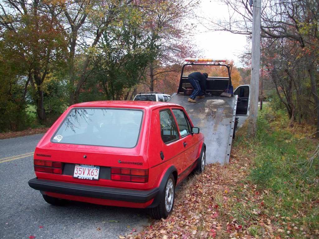

rewind to this past thursday night we had installed a peloqion shimkit in my gti
had a hard time reinstalling the circlip on LT axle cup but we managed to get it on after fighting it for a while.
drove it around the neighborhood a while and it felt good
fast forward to this mornin: was headin to an end of the season GTG i had arranged a couple of towns over
was an awesome backroad drive
pulled away from a stop sign and towards the top of 1st gear felt something let go
car wasnt accelerating even though the engine was revving fine
so i popped the hood and sure enough... the circlip let go so i had to get it towed
