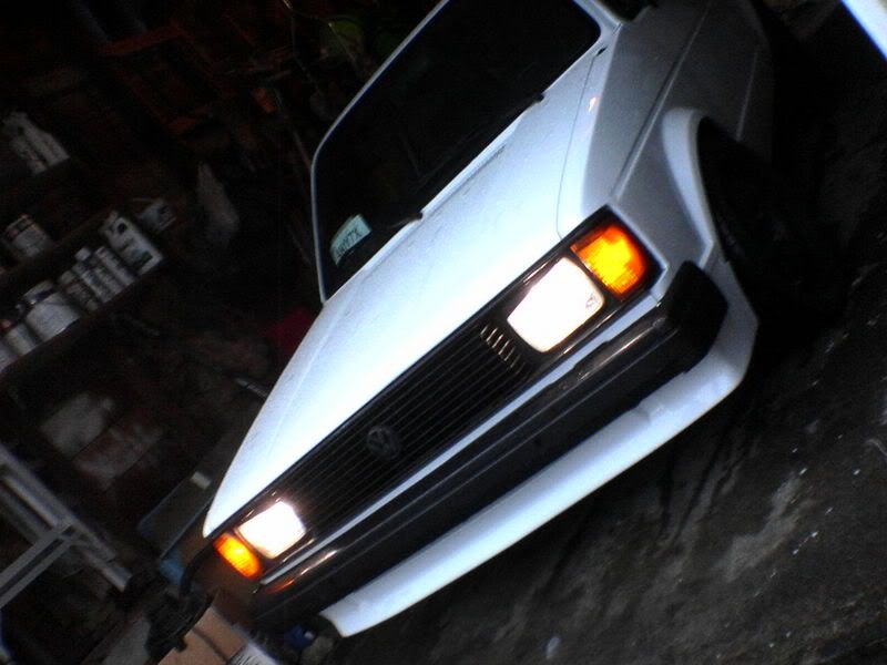

My 84 GTI seems to be getting terrible gas mileage, i just started daily driving her a couple weeks ago and i have already gone through 3 tanks of gas.
its got a cam and some other little mods here and there but i kind of expecting to get better mileage than this i mean after all its only a 1.8.
so basically i am just wondering what kind of mileage you other bunny owners are getting?
my car has gotten about 250 km for this last tank....
is this normal or is there something going on here?
