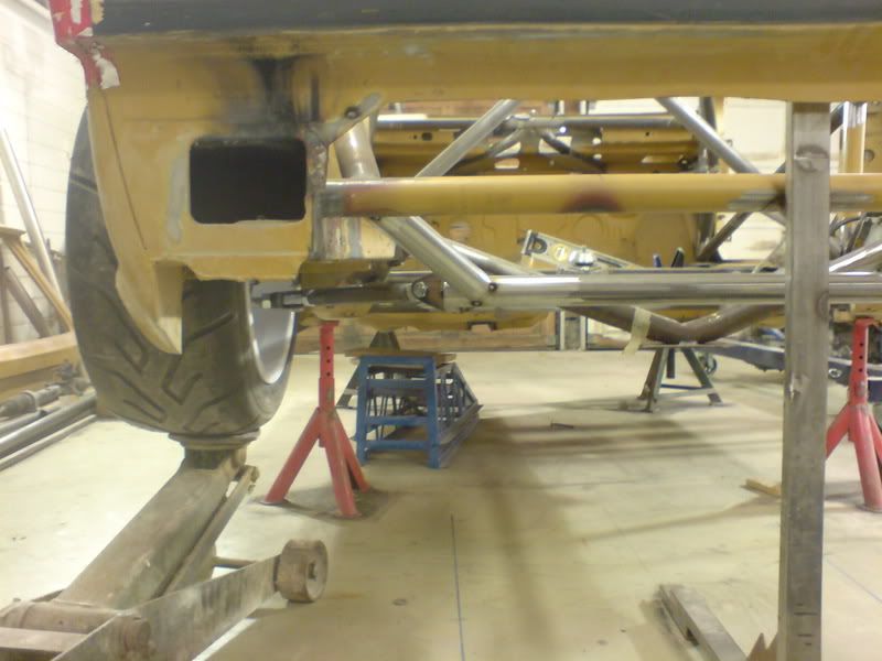

Update!
Have got the controlarms mountingbrackets on and it looks like it woul work pretty nice. This pics shows the angle of the controlarm when it sits on the ground at normal ridehigth, a bit better then before I would say
Then i started modifying the frame to make place for the driveshafts, and it need some "minor" modifing to work but i think i got it all sorted out for now, think this will make up for the loss of the org frame.

Re: (secondgen)
Don't know if you thought of this or not but did you make sure that your control arms are not going to hit the body when they are at their maximum compression?
^^^X2 and will there be enough room for suspension travel? I know your going to be running really stiff racing suspension but you never know....

Re: (DrakepwrdRocco)
Quote, originally posted by DrakepwrdRocco »
The control arms will not hit the body before the shocks has been compressed 4 cm wich I think is enough, with that much compression the floor nearly hits the road.
