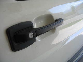

-Mk2 rear door handles work on front doors for the shaved lock look

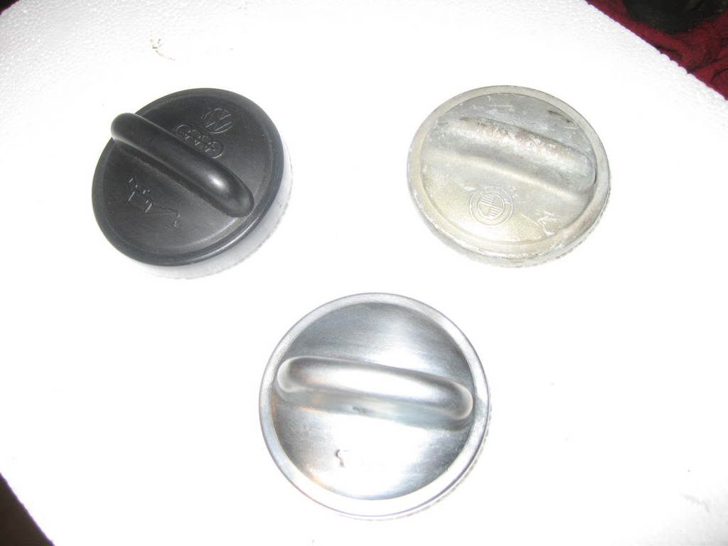

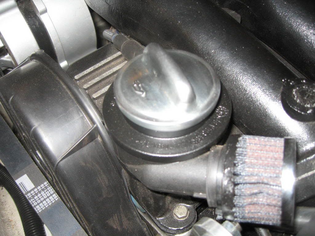

-Most oil caps on Aircooled, Mk1, Mk2, and mk3 8v, Fox, and some Old School Audi 5cyls are interchangable.
Old bugs, some rabbits, and very few a2's,and some turbo Audi's had either Chrome or Galvanized oil caps.
They are pretty easy to polish.. obviously the chrome is a bit shinier, but with some elbow greese you can get a galvanized cap pretty shinny as well.
...older BMW caps are also galvanized and do fit

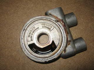

-Turbo Volvo's have an oil cooler w/ a sandwich plate that will bolt directly to a VW
(8AN-16x1.5mm fittings that fit into the adapter plate)

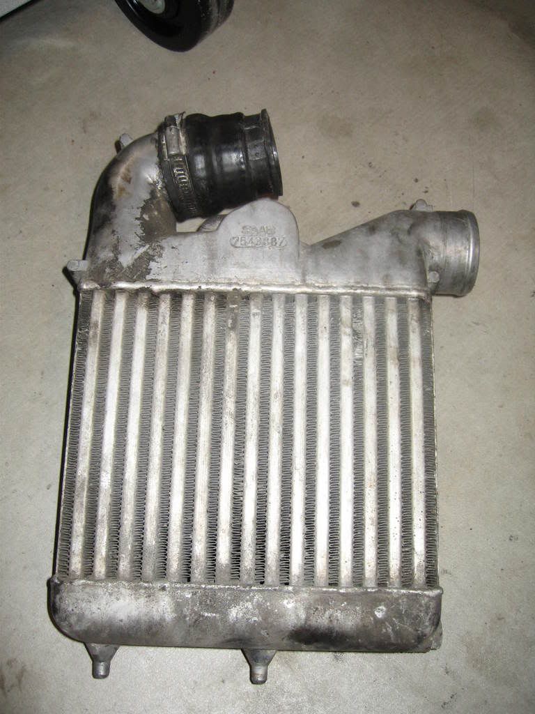

-Intercooler off of most FI cars for Turbo and SC cars Volvos,VW,Saabs,Audis,ect

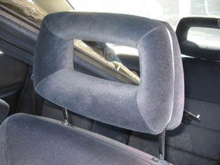

-Audi 90 hoop style headrests fit our seats
-shave door handles use a trunk popper from any fox platform mustang (Late 80's early 90's Mustang. Not sure how far back they go but the last year they were built was 93)

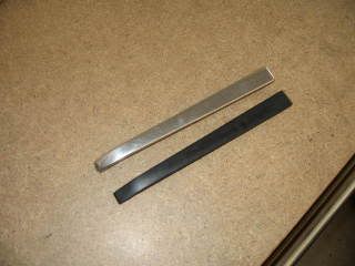

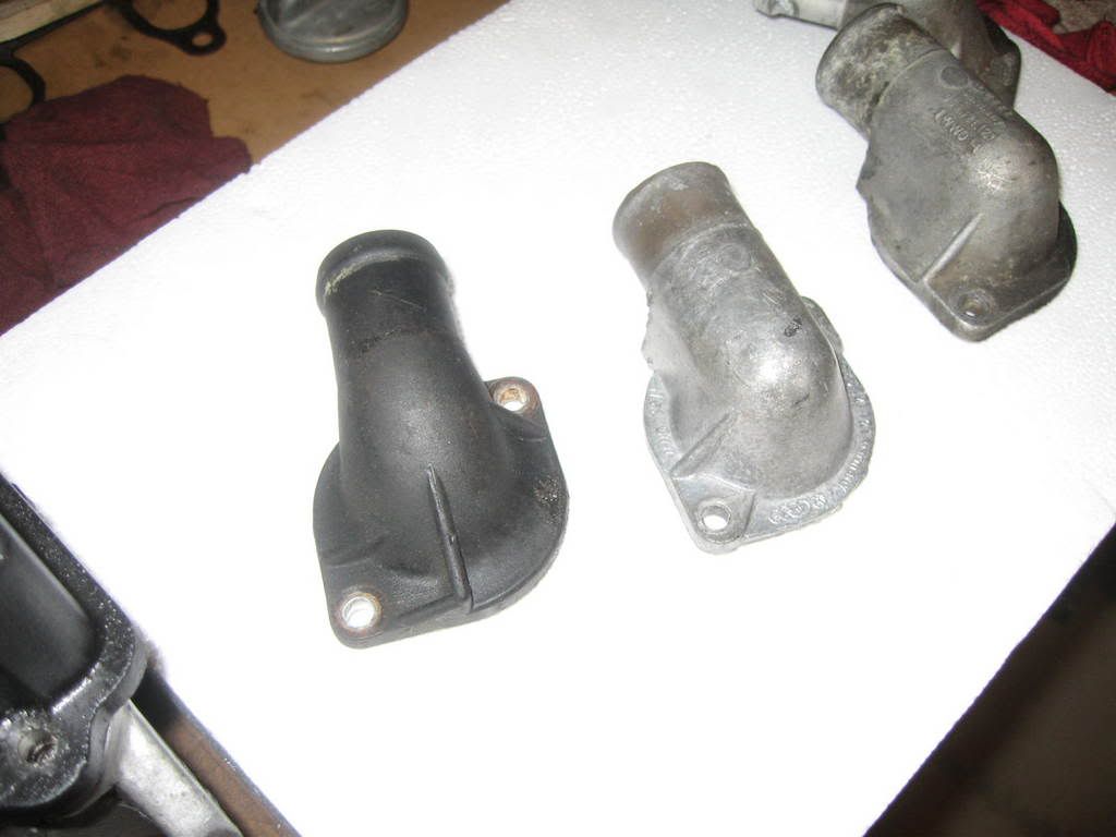

-most mk1s some older mk2s have metal flanges over the thermastat on the pump before vw got cheap and went to plastic
This applys for most of the flanges on the head and block of early cars
Also applys to the breather on 2.0 16v early ones are most likely metal

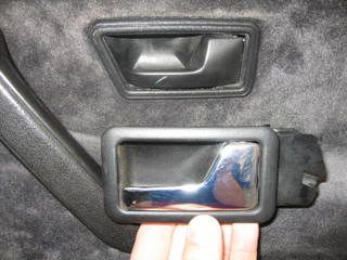

-The door latches(part that hits the striker) from an Audi 200 (nice crome ones) will fit on a mk2 w/ a little modding of the rod in the door inside pices from your old one.
-European passats/santanas gx5 inner door pulls are chromed and fits nicely on mk2 golfs/jettas... maybe quantums or similar in america have the same !!

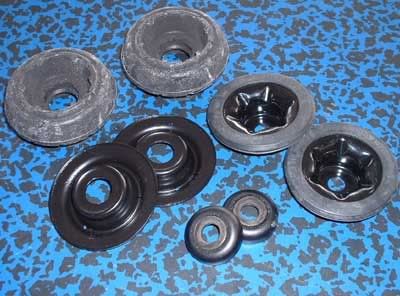

-Vr6 strut mounts are a a good upgrade up front

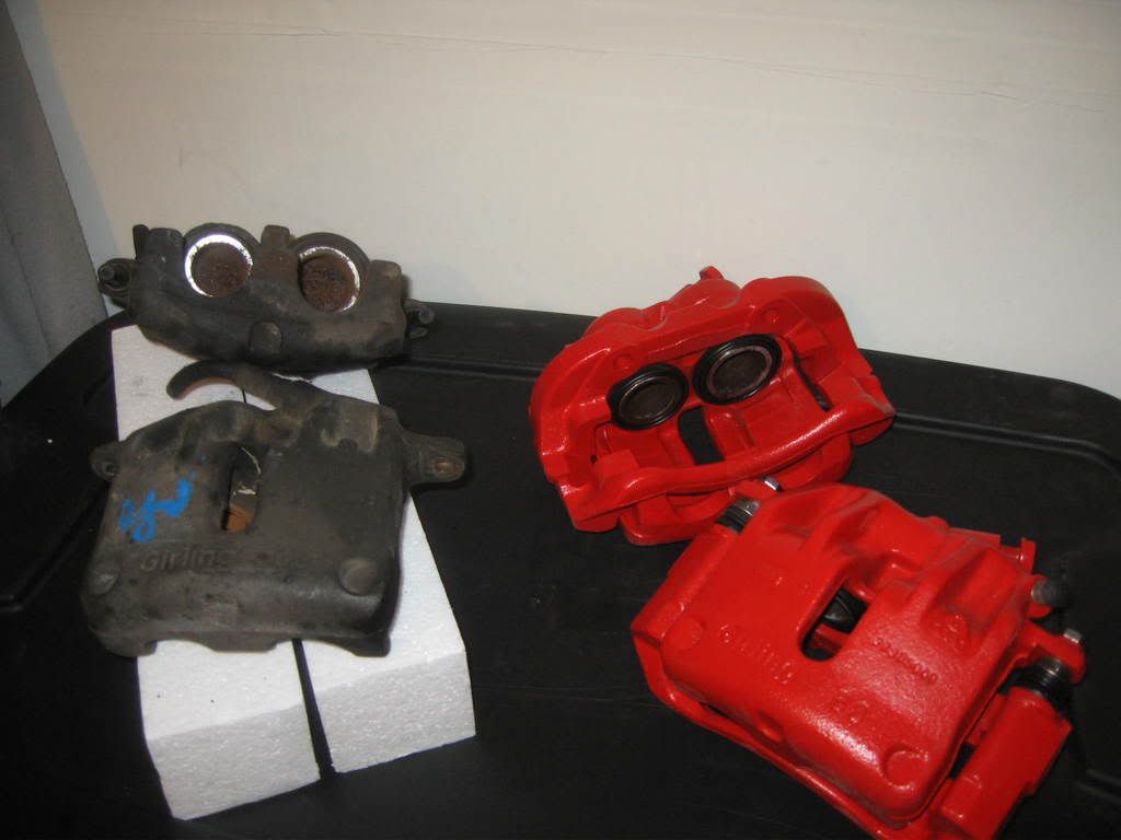

-Rear disc brake caliper from any Audi(NON-Quattro) will fit MKII rear disc assy,
-The necessary spindles for upgrading front brakes came on 10.1 mk2 16v, Corrado G60, just about anything with an ABA (don't forget cabrios and B4 passats), and four-lug B3's.
If you go 11" brake, your old 14" won't fit on the front anymore 15"req.
-Girling 60 calipers came on a variety of Audis (100Q, 200, 200Q, 5000Q/T/TQ UrA6,S2, Quattro, V8). Just look for the two big pistons and the "60" marking. The carrier is needed too.
