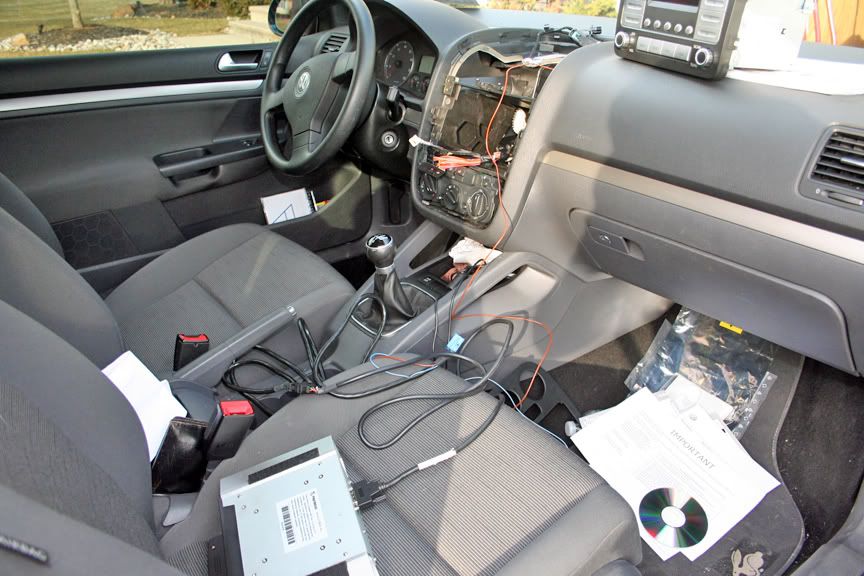

Need some help installing a Phatnoise that was previously in my Mk4 Jetta into a friends Mk5 2008 Rabbit (No Sat/No Premium Stereo)
We've already purchased the following part from Impex 1T0-051-592

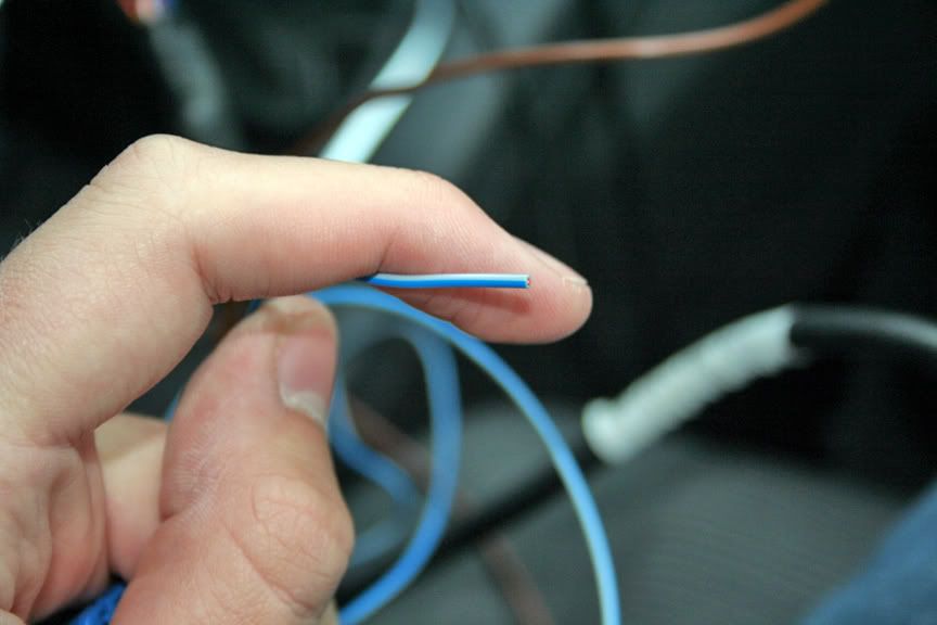

#1) Does anyone know what to do with the loose Blue/Gray wire? We know that they loose Brown wire is a ground
#2) We've hooked up the Phatnoise to the factory Premium 7 radio but when we switch to the CD control it just reads "EXT AUX IN" and neither the Red or Green lights are illuminated on the Phatnoise Unit

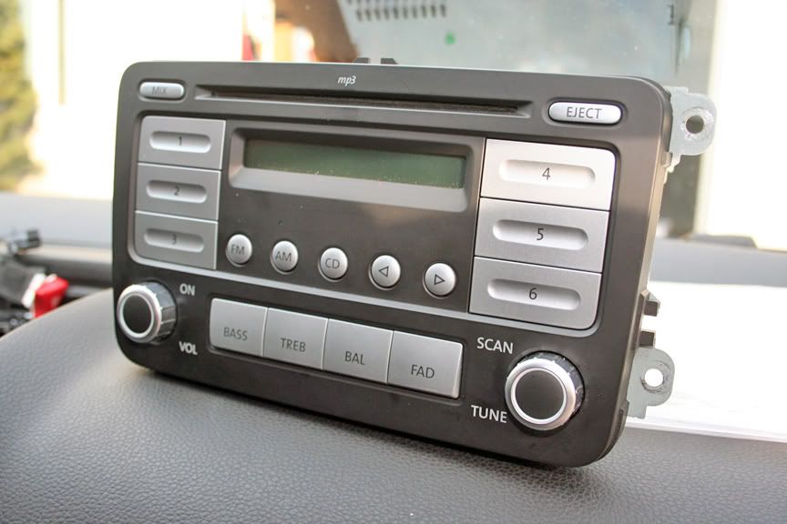

#3) Once we get this all figured out does anyone know the configuration setup for coding this to a Mk5 Premium 7 Head Unit. I found this elsewhere for the RCD300 head (dont know if its the same) so if anyone else can confirm that would be great. "To set up the head unit, when it is switched on, press 6 then the right FF button till it reaches track 12 where it will say something like select head unit type H then press the right hand knob in to select."
Premium 7 Radio

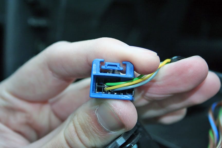

Factory Blue Plug on back of Radio
New Blue Plug Adapter for CD Changer/Phatnoise
What is this loose Blue/Gray wire for on the new CD Changer/Phatnoise harness??

this is not premium 7 radio
I am not sure if that's the problem...
Premium 7 is printed clear as day on the side of the head unit so I assumed that's what it was called. Part # 1K0 035 161 C
If it's not a Premium 7 then what is it?
Modified by VacantSkies88 at 4:21 PM 2-1-2010
248 Posts
Re: (VacantSkies88)
i believe the part number for the premium 7 is 1K0 035 180... i think
i have the radio you got there, all i know is the premium 7 is the one with the cd changer, which we dont have
