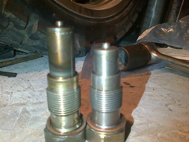

so i intalled the upper tensioner on the engine after having all the guides and that stuff installed, and engine all timed, but when i install the upper tensioner it seems as there is slack in the chain? am i missing something ? do i have the right tensioner?
i heard something about filling it with oil and getting air out of it? what does that mean...??
grab both ends of the tensoner and submerge it in oil. squeeze the plunger a few times. you should get a few small bubbles out of it. then install it and you should be good.

Just looks like it's collapsed to me, as stated you've got to bleed with oil.
Not really but if it's a rebuild and you are using straight weight, use that, if not a lower end rebuild then just use whatever oil you use.

Is that your new tensioner, if so that is the old style one and can only be used with the metal upper guide. That type also needs to be bled.
The newer style (flat faced) wont need to be bled and the upper guide will last much longer. I would get the upgraded parts now.
