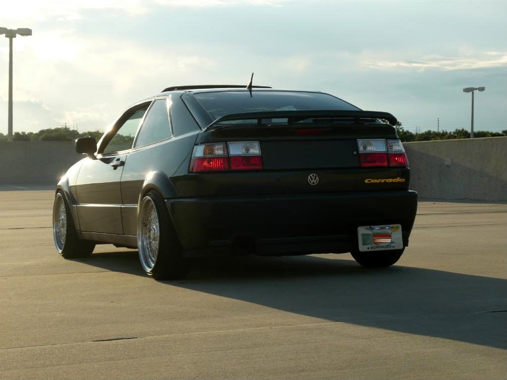

I was searching, what will be the best ET to run for a set of 17x9 all around with ET52 ??? I would love to have to rolled fenders only... I search and only saw a Corrado with that kind of set up--- 17x9 all around with ET33 front and ET21 rear
i am thinking to use 205-40-17 Falken 329 front and Toyo T1R rear
i need this info so i could buy the adapters for them!! 5x120 to 5x100

p4c rado with wheels!

I've read all that post bro... and no one is running 17x9 all around on a MK3
I was talking with Mexican and he told me I could be able to run ET30 front and ET20 rear so I'm thinking on running adapters of 22mm front & 32mm rear!
That could look good with just rolled fenders??...and with 205-40-17 Falken front & Toyo T1R 205-40-17 rear?!??
