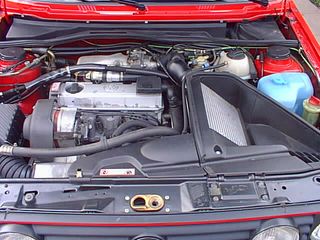

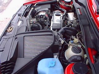

how do i make this
look like this? (what parts do i need to tranform into that intercooler, )
please help the newbie

i have one of these.
stock golf G60 with air con.
you need the i.c., piping(i replace stock ones with custom )charger outlet and the cover plastics...
not the best setup but i want to keep it stok so one day i wiil adapt a colling fan cuz when driving in city if you put your hand in the i.c you will get burned(serius...)
anyone have a fan already adapt?
how(pics welcome)

Just another post confirming what's been said already... even though that I/C looks awesome, it's seriously inefficient and uber expensive. You could get a nice Air/Water I/C for hundreds less than the price of that setup that will seriously outperform the stock version.

I was told the top mount golf intercooler is just http://****************.com/smile/emthdown.gif
Look for the golf g60 front mount, or get a custom front mount. Or, the cheap solution is the corrado intercooler.
/Carl

does anyone seen a cooling fan on the top mout i.c.?
the i.c. gets hot cuz the engine makes it hot.
if i can put something to keep away the hot air caused by the engine it will be much more efficient...
