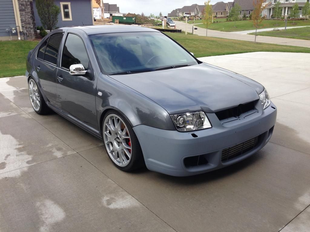

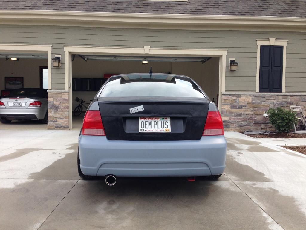

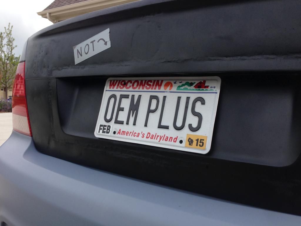

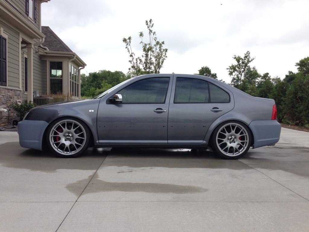

Outdated pictures from 2011:
Crappy pictures from 2012:
2013 looked the same as 2012, but I was missing the front bumper. Here's 2014. It's not looking good:
Current stage:
