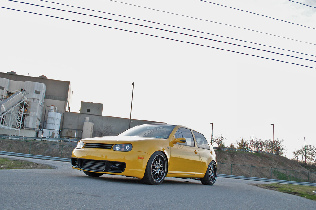

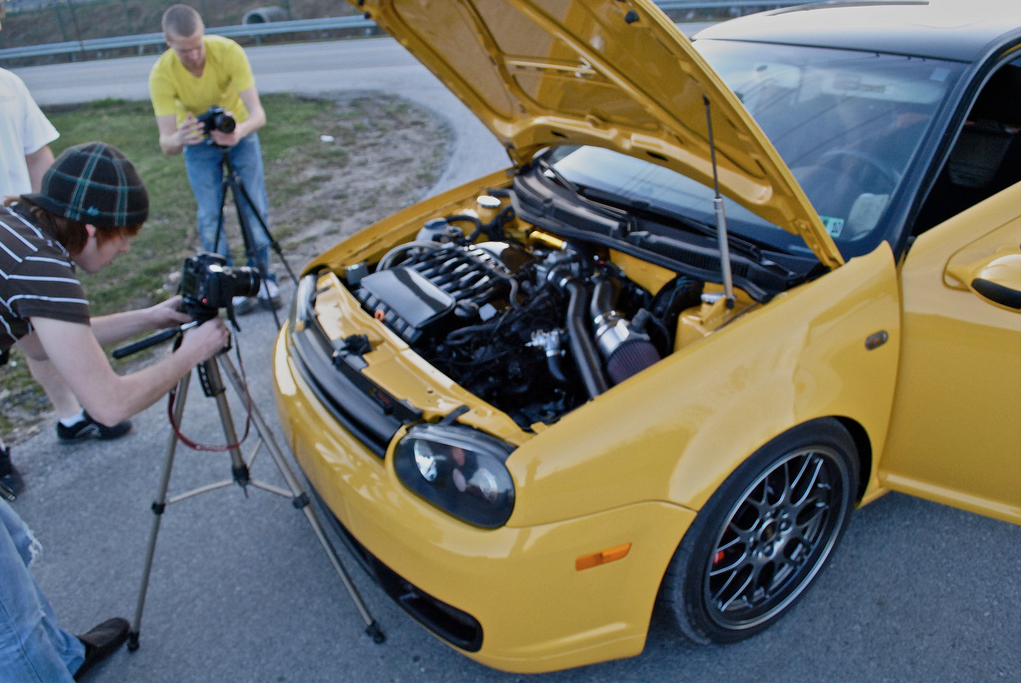

PICS for the masses

edit: Beautiful car, btw... How much boost are you running on that OEM manifold?

14.5 psi and it;s been holding for 2 years now!!! i have a short runner in the works me and my friend are going to fab. up. car puts down 390whp on 13.5psi in summer. cant wait for the manifold.
