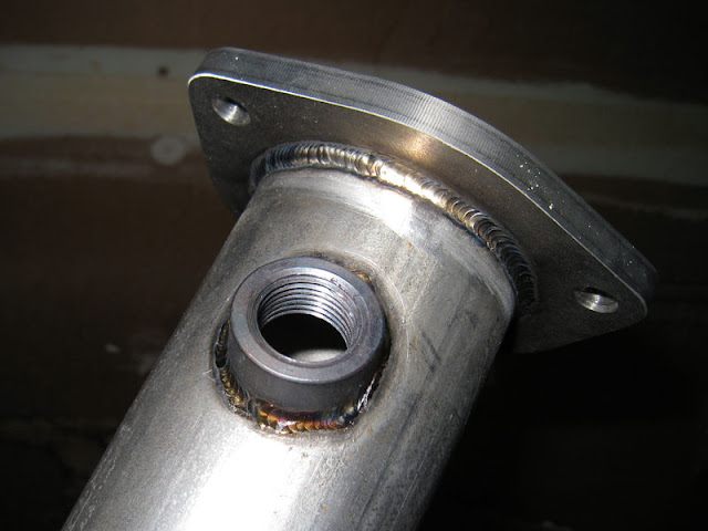

A photo of the welding:

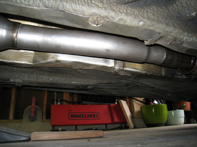

A few photos installed:
