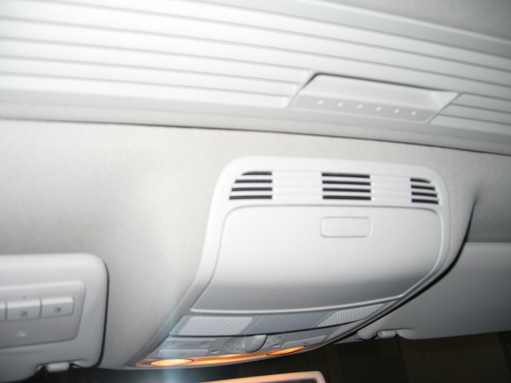

After dealing with a stick-on mic placement of my Motorola bluetooth system, I finally decided to do something about it.
I wanted to put the mic into the overhead console. It was a little more difficult than I thought, but the results were fantastic. The mic is now invisible, and sound quality is great!
Thanks for all the help on the 'Tex and OEMPL.US:
First I had to remove the console, here are the directions http://forums.vwvortex.com/zerothread?id=3341654 The light lens just pops out, I used a thin blade screwdriver, very carefully!

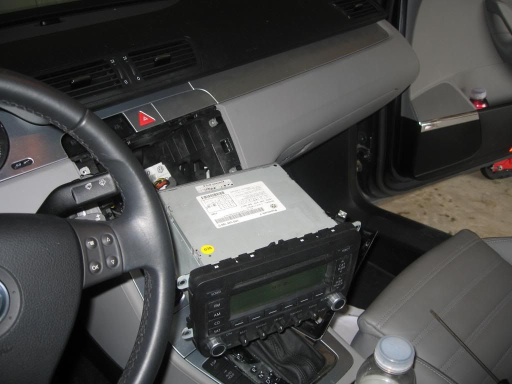

I had to pull the radio to unplug the mic cable in order to run it properly, like this: http://forums.vwvortex.com/zerothread?id=3376169
The A pillar had to come off in order to run the cable behind the dash:
http://oempl.us/article_info.p...60ccb
I ran the cable from there under the dash and back to the radio well.
It was important to me to have the cable to be invisible, so I ran it in the same cable run as the wires for the sunroof...
I used a fish tape in order to run the cable in the headliner, down the A pillar, and under the dash
I took the mic out of its housing, and put it into the top left rear vent of the console. Here's a close up of the mic in the housing, before the cover is reinstalled:
And the completed install! The mic is in the left vent...
The project took about 2 hours, a lot of the time was getting the cable properly run through the headliner. The sound quality is great, I can speak in a normal tone now, and no little mic sticking out like a sore thumb!

How's the audio quality of the mic in this location? (you have the Mot mic, right?)
I saw some mixed reviewed in other posts about mounting the Parrot mic in the overhead console, although I think they may have been mounting it in the section a bit more forward to the middle/left of the compartment (the area that looks like a speaker grill).
thks...
#5 ·
Re: (reef150)
The sound is excellent...
I purposely did not mount it in the middle grill, it doesn't face the driver, and it's on the wrong side of the cabin...
I am very happy with the install and the sound quality, I get to speak in a very normal tone!
