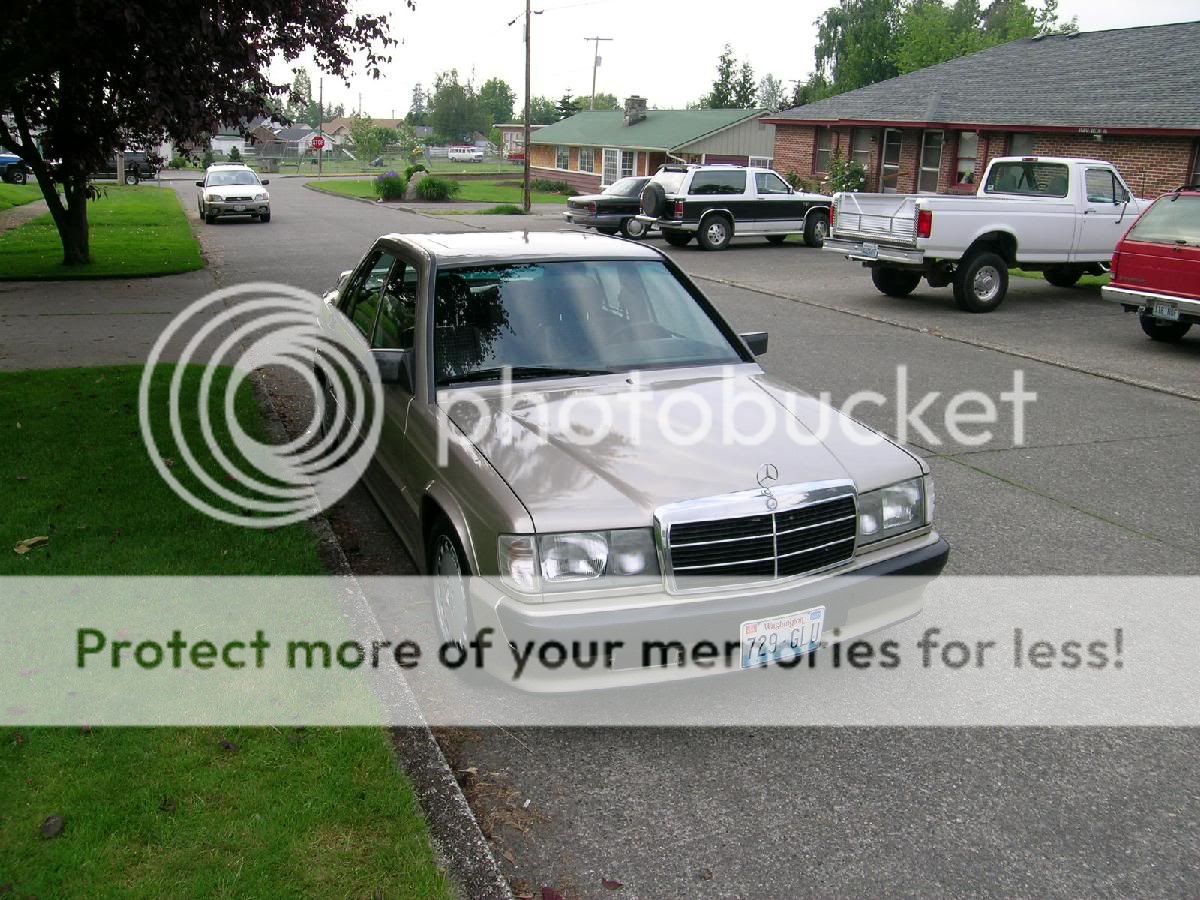

So i bought the 1985 190e 2.3 16, but it doesn't like to go into reverse. Once you are there its fine, but finding the gate/negotiating the safety lockout is neigh on impossible. As you might imagine, this is making my life difficult! Does anying here know their way around a mercedes dogleg five speed manual? Or can point me to a Mercedes Vortex?
Here it is:
Thanks http://****************.com/smile/emthup.gif

I can't help ya, but got any more pics of that car? Looks nice!
