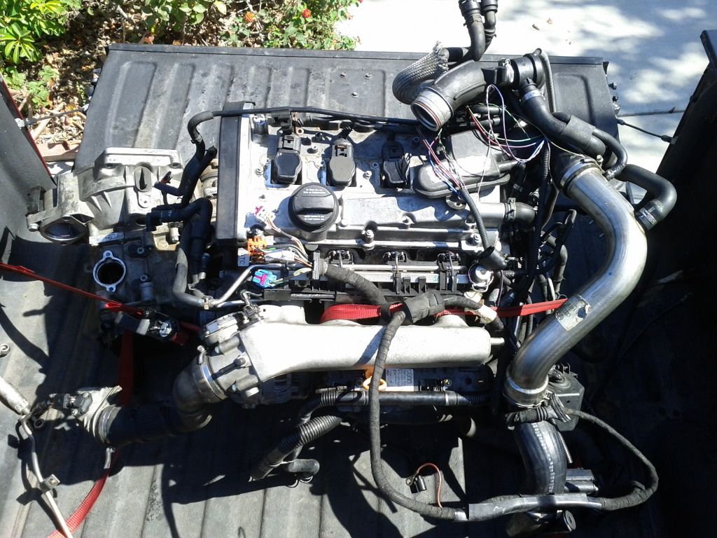

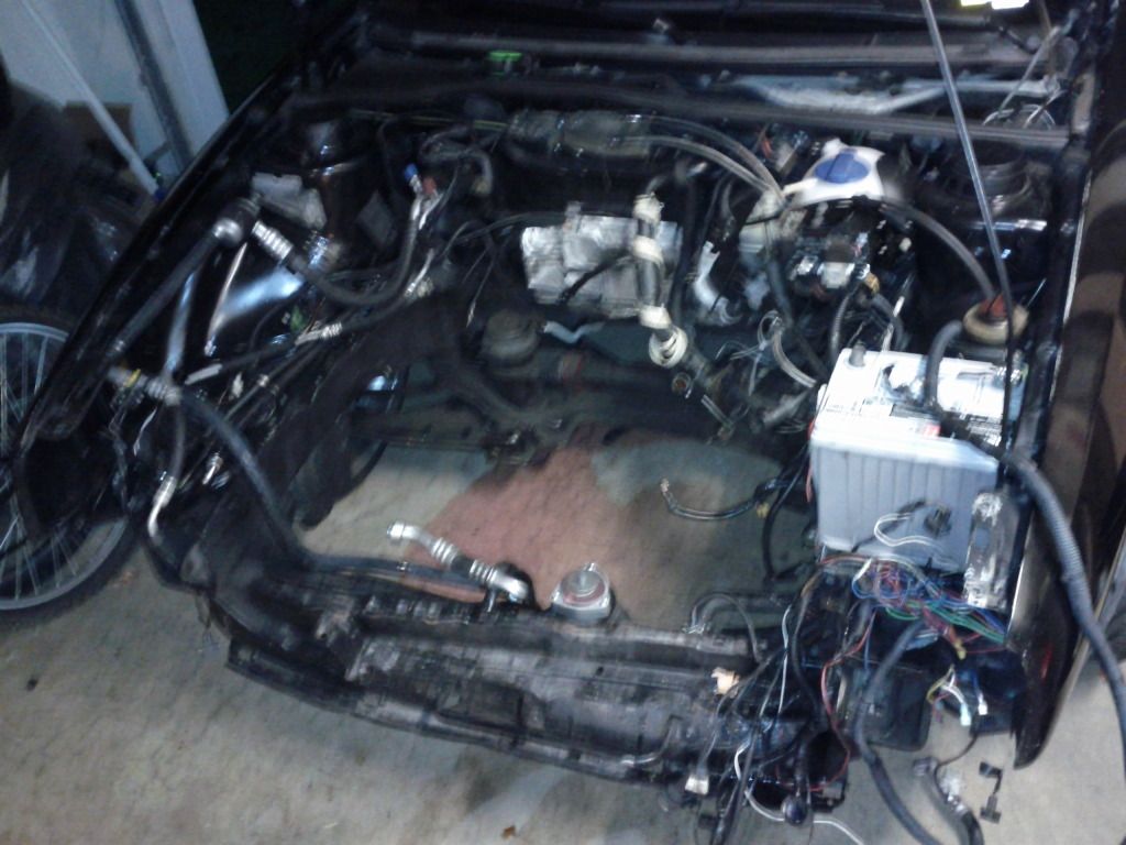

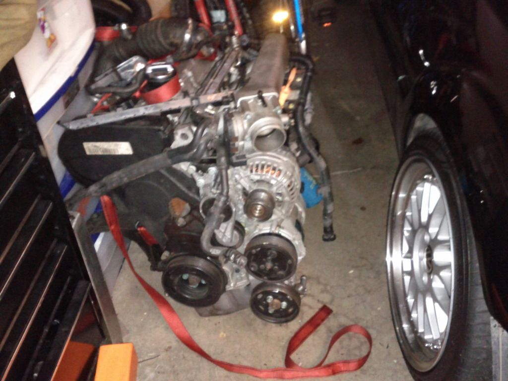

I know what your thinking. Why in the world would you swap a 450HP VR6-T engine for an Audi TT 180HP. Well it was a almost very easy. I've had it for 8 years of countless hours...... 4 transmissions.....you know. The biggest thing was;which its crazy. It was also my daily driver. Being that I'm in the NAVY the luxury of having a third car when bouncing from here to there it becomes too much. I had to make a decision to get rid of the Corrado (Not an Option!!! I told the wife) or get a fun engine that can be reliable and I can have fun with. I looked at the the 1.8T and it became obvious the direction i was going. So I found a 1.8T from an Audi. I wanted to share my swap with you guys and hopefully it can help anyone.

just picked it up.
It will be missed!!.
It fits.

What's the mounting situation converting to 1.8t?
Sent from my EVO using Tapatalk 2
If you have a VR6 like myself all you need is the ABA rear mount bracket, TDI front bracket P/N: 1H0 199 273B,
and use your transmission bracket. The down pipe fits perfect depending what motor you get. I got an ATC from an Audi TT 180hp. I'll be posting some new pictures tonight.

The corrado bay is close if not identical to a mk3 bay...
I used a mk3 aba rear mount, and the according 020 front mount that i re-drilled.
Works a treat!
Btw op, keep up the good work! I took alot of heat for pulling my VR and putting a 1.8t in... Things seemed to have calmed down about that. =]
