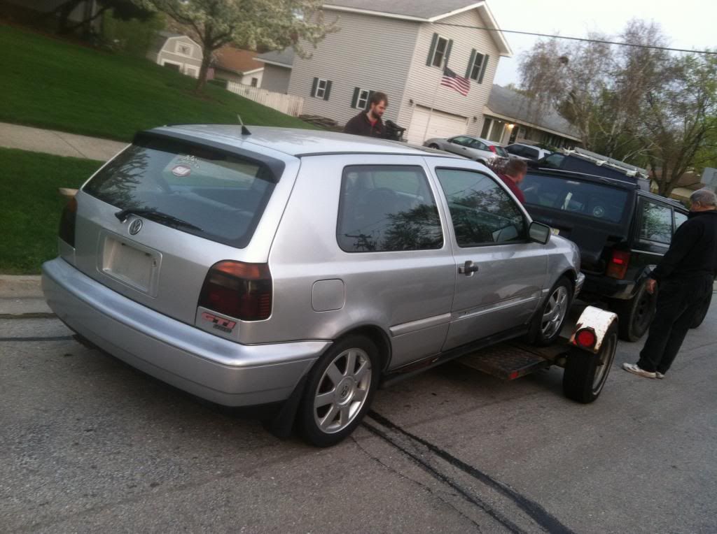

Day of pick up. Half the car was stored on the driveway, the other half was in the yard. I had to unhook my jeep from the dolly and yank the gti out of the ground :eek:
