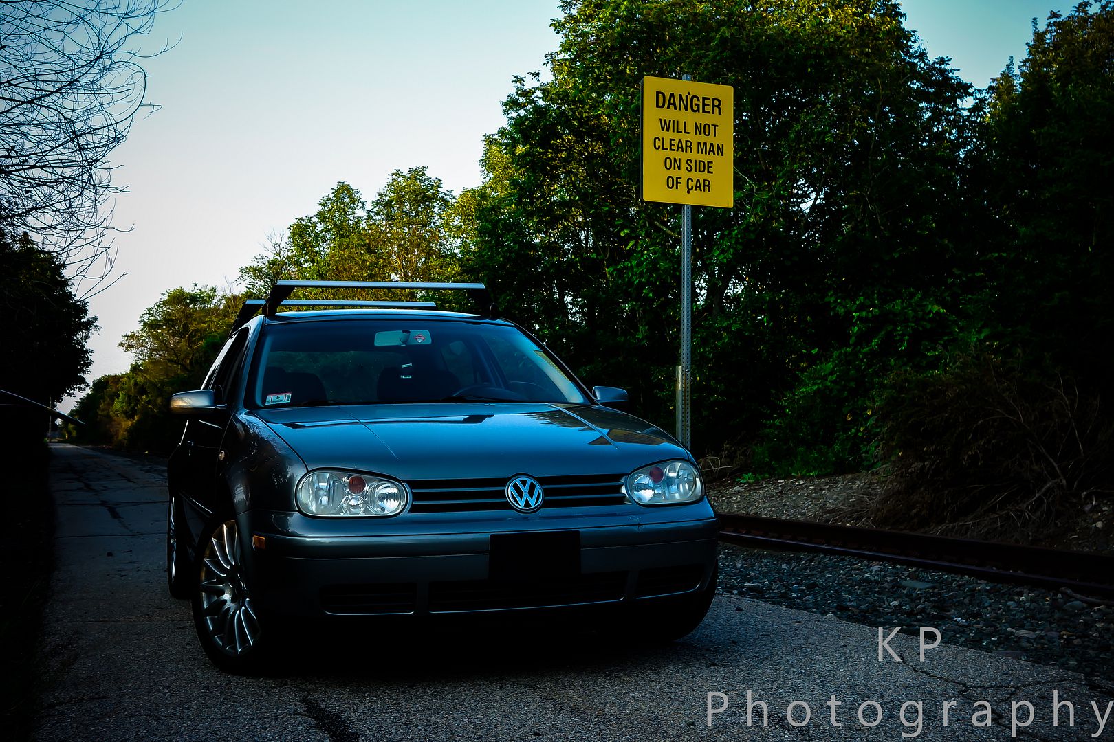

So I figure after about two years, I would now put together a build thread primarily so I can keep track and when people ask me, I can just show them this. So I will Updating all the previous things that I've gone through with the car and my experiences. I want to put up as many pictures as possible but some I just haven't taken :(
You can Always Check out My Flickr
First Few Details About The Car
April 9th, 2013 My good friend Brandon, which his GTI heavily swayed me into getting one, Drove up from MA to Hudson NH after school, not thinking i was going to buy this car, went with cash, Just in-case it was worth it. Yes it was worth it, i ended up buying right there on the spot, and the guy gave me a pair of Winter tires with steelies. Car had minor blemishes for a 9 year old car. Exterior I'd honestly say 6/10. Chipped driver side mirror housing, plenty to scraps, and starting to get the typical MKIV Fender rust on driver side. Didn't check the carfax until January of 2015, VERY CLEAN CARFAX, almost all dealer maintained. But the car checked out mechanically and drove exceptionally. From there it has been a major money pit and a delight! Read on and follow my journey with the car!
Year: 2004
Make: Volkswagen
Model: GTI 1.8T AWP 5-Speed
Color: Silverstone Grey- LD7W
Bought: April 9 2013
Miles: 111,000
Interior: Black and grey Cloth, I would say a solid 8/10. Needed a new center console cover, besides that, and new Floor mats, everything seemed to be clean.
Goal: Keep a Very clean OEM+ car. Initial goal was 350WHP and 350WTQ in that ball park, but build up to that point. I didn't want to do too many crazy things like slam it, or put hardwood floors in the hatch or things like that,I wanted to keep it practical and just really restore it mechanically first, and aesthetically after. Its been my daily Driver ever since, except for the first winter of 2013-2014, I drove my 97 Honda Accord due to some electrical issues i will post about later. And the month after when i bought my RX-8 ;).
New Goal: Realistically I want to get the car to atlas 200k Hopefully dreaming about seeing 300k. I stay ahead of maintenance and always (try) to do it right the first time. I will only use OEM or OEM+ (Better than OEM) Parts. No sense in cheaping out and not taking care of it, the Germans really knew what they were doing. Everyone who hates these never treats them right and they treat it like a Honda and drive them into the ground too soon!
Oil: Castrol Syntec 5W-40 every 3,000 to 3,500k
Oil Filter: Fram Ultra Synthetic (Large Passat Filter Starting at 156k)
Spark Plugs: NGK PFR6Q (Platinums) @111,000k (Copper Starting at ~135k)
Gas: ALWAYS 93, typically Mobil, Shell, or Cumberland Farms(Gulf)
