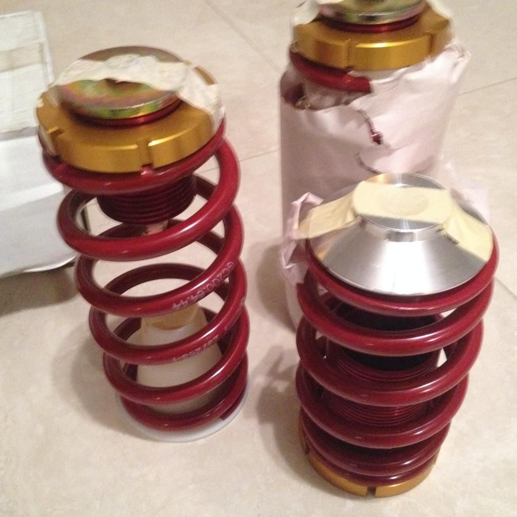

So last summer I focused on suspension. Put ground control/Koni sports all around.
