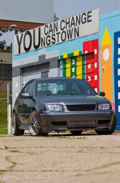

1,582 Posts
Car:
2004.5 GLI | 53,000 miles
Engine: Head:
AEB Head
Supertech Exhaust Valves w/ Single Keeper Grooves
Rosten Springs
Rosten Ti Retainers
Piper Cams
Full Port and Polish Intake and Exhaust Ports
Engine: Block:
AWD Block bored 83mm
ABA Crank (2008cc)
Ross Racing Pistons
Scat Rods
ARP Main and Rod Bolts
AE Racing Main and Rod Bearings
Turbo Kit: Pag-Parts Bottom Mount
Vbanded Turbo Manifold
Standard 3076R .63AR Housing w/ 4" Inlet and 2" Outlet
TiAL .030 Oil Restrictor
Oil Return Flange Kit
Oil Pan Adapter Kit
3" T304 Stainless Downpipe Vband Clamp
3" 6061 Aluminum Inlet Piping Set w/ Silicone Connectors/Clamps
TiAL 44mm Wastegate
Dump Tube Open Vband Clamp Manifold-Turbo
Silicone Charge Hose Kit w/ T-Bolt Clamps
870cc Injector Set
870cc Eurodyne File w/ Maestro
Bosch 300lpm Fuel Pump Kit
