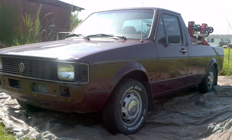

So, on July 26th, I picked up my new project. a 1982 Caddy Diesel with a broken timing belt. Body is in fair shape. From what I could tell, body was in decent shape. Shock towers seemed solid, floors seemed good.. Had some rust bubbling though in one fender, one A-Pillar, and one B-Pillar. Its a 5 speed truck, with a gutted dash.
Plans are get the 1.6D running again, but later replace it with a 1.9TDI or AAZ.. Roll on 14x8 and 14x9s and coils and rear axle flip. Paint to be BMW Leguna Seca Blue.. I have a friend with an 01 M3 and I love the color.
The rest of the details will sort themselves out.. But I originally planned to have it repainted and together by the first week of October or so..
Here she is when I first got her...

Got her offloaded into her temporary parking spot out back. The truck came with 2 bed loads(the caddy and my dually), and a cab load of spare parts..
Interior Looks pretty good.. Too bad theres nothing behind the dash..
The very, uhhh, lively painted 1.6D
